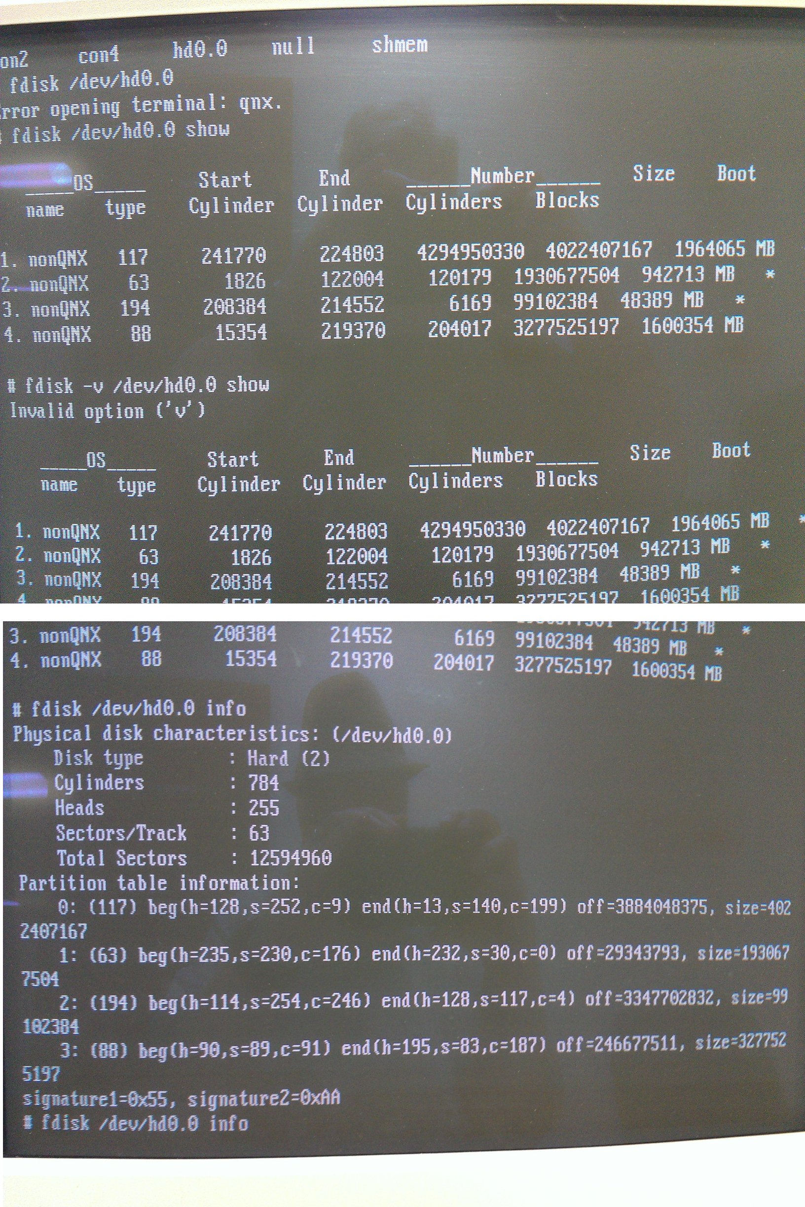

Re: Development Computer Stopped Booting - Newbie in Trouble
Thanks for the input!
Unfortunately, I don't have a record of the exact partition values - didn't run into that tip until after the crash.
Attached are the fdisk show and info results.
I don't think the partition info shown is accurate, as the values aren't very close to what I had recorded.
Any input if you look at these is appreciated.
I'm going to take a look at the gpart utility - thx.
If that doesn't work, I think I'll try to slave this HD in the new system I am building - just to try and get everything
 backed up somewhere.
Then, I'll try the partition repair as you've laid out - again, thx.
Attachment: Image fdisk_showandinfo_aftcrash.jpg 984.64 KB
The fdisk output shows that you replaced primary boot loader and
partition table by secondary OS loader.
By the dinit -hb /dev/hd0.0 command you've wrote secondary loader to the
MBR.
When you use dinit on a partitioned hard disk you should always specify
a partition (dinit -h /dev/hd0.0t77).
Any way first of all you should restore your partition table and I think
you are on the right way.
Pavel
