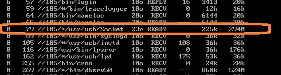

Hi, there has been a problem with the "Socket" (QNX 4.25) to a disturbance in the management network of the company . "
Socket" consumes memory and CPU disabling the node (image in attachment ). It has happened in many servers at the same
time but not in others connected to the same network. Versions of "Socket" used in these servers with the problem is 4.
25K and 4.25H. Versions of "Proc" used in these servers is 4.25Q. The "resolv.conf" is configured with the nameservers.
Please, somebody I will guide to fix it?
Thank you very much.
Sebastian Cerella
Attachment: Image Consu.jpg 59.35 KB

Oleg, I did not include what you request because it happens on different servers with different functions. The variety
is great. I am attaching for two of them. I add in only one, because the other not have, syslog logs. The option of
moving to 5.1 is that we know we should do but that involves a significant cost to the operation of the plant (steel).
Unfortunately, I don´t know the network scheme because not manage us. It´s the management network of the company.
Beyond this does not seem normal that a process starts to consume memory.
Thanks for your answer.
Sebastián.
Attachment: Text SocketProblem.txt 43.69 KB
