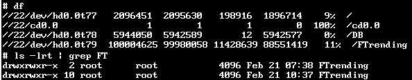

Hi, I could mount a partition with the same name that a directory. Is it an error of mount comand? Is it possible
correct it?
The PC was installed with the CD 2009.
Thanks in advance.
Sebastián Cerella
Attachment: Bitmap Mount Error.bmp 8.67 KB

Hi Sebastián,
Sorry for the delay with answer. The possibility to mount to the existing
directory is not an error. You can read mount() function overview in QNX4
Help. But output of the ls utility is incorrect.
Please, describe your problem more closely. Is something else (expect the
ls) working incorrectly?

Oleg, I noticed the problem when I had to delete the contents of the directory. What does the Fsys when run "rm
FTrending/* "?

Hi Sebastián,
You can launch rm with -v option to see what files were deleted:
$ rm -v FTrending/*
You don't have access to files in directory FTrending, but only files in
FTrending mount point.
So I see only a little issue with ls. I'll fix it and then inform you.
