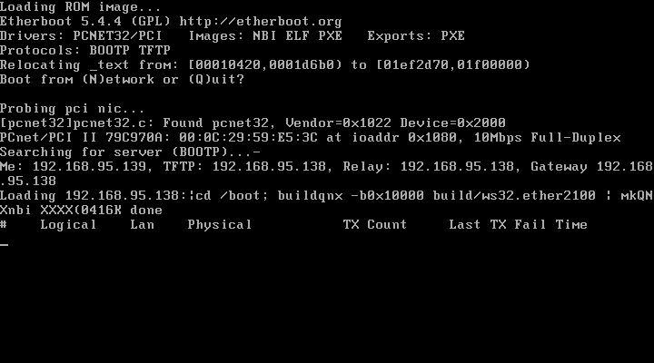

Re: minor fault in the QNX4 Net manager
Hi Oleg,
I've setup two small vmware virtual machines one with a file system (the core node),
and one with just a pre-build boot file (the boot node - /boot/build/ws32.ether2100).
If you open both in vmware and add qnx/tcprt licenses to the core node,
the boot node doesn't start up a login prompt until it receives a packet from the core node (start nameloc).
The vmware images can be found at http://users.tpg.com.au/kleake/qnx-oleg.zip
Karl.
Hi Oleg,
That doesn't seem to work because the shell will strip the new quotes off
and then buildqnx will replace $(netmap) with the netmap environment variable which
includes it's own quotes
"1 1 000c297700f4"
tftpd does something like
    sprintf ( string, "netmap=\"%d %d %s\"", node, lan, mac_address );
    putenv ( string );
    // then runs a shell to build the boot image
I can work around this though if I change my bootptab file from
:bf=|cd /boot; buildqnx -b0x10000 build/ws32.ether2100 | mkQNXnbi:
to
:bf=|cd /boot; fix -b0x10000 build/ws32.ether2100 | mkQNXnbi:
where fix strips all the quotes from the environment variable netmap
Hi Oleg,
We have followed the qnx 4 documentation for dynamically booting with bootp/tftp almost to the letter
http://www.qnx.com/developers/docs/qnx_4.25_docs/qnx4/user_guide/netinstall.html#BOOTP
http://users.tpg.com.au/kleake/bootpd.html
( this link is dead http://www.qnx.com/developers/docs/qnx_4.25_docs/tcpip/user_guide/utils/bootpd.html )
tftpd sets the environment variable.
Updated virtual machines to do a full bootp/tftp boot,
including the binary to strip off the offending quotes are at
http://users.tpg.com.au/kleake/qnx-bootp-oleg.zip
(the ip addresses need to be updated in /etc/bootptab if you get an ip address other than 192.168.95.138)
I have attached a screen shot of the boot node with netmap built into the boot image.
Karl
Attachment: Bitmap etherboot.bmp 843.8 KB
Hi Karl,
You are right, the tftpd sets $(netmap) variable with a quotes. So simple
way to fix this case would be removing quotes from the environment variable
(i.e. using your own fix program).
