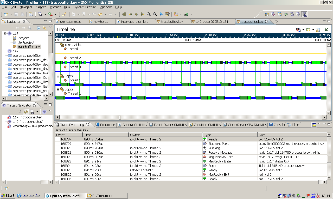

Here's a screenshot of the log.
Attachment: Image udp1.png 97.28 KB
Re: local UDP Echo test three times slower on QNX than on Linux
The kernel trace log. It clearly shows io-pkt being very busy, and also it seems the client wakes up a 2nd time before
the server processes the first echo, not sure if my interpretation is correct though.

RE: local UDP Echo test three times slower on QNX than on Linux
Quick note on the client waking up a second time...
You can see from the events that io-pkt is broken up into long and short
processing intervals.
The shorter interval happens as a result of a recvfrom from the app
(i.e. the app is asking for data but there's none immediately
available).  Io-pkt is squirreling away the information that someone is
waiting for data (and also does a quick check to see if any other
threads have dropped IP packets into the queue to be processed).
The long interval is a sendto transaction.  The localhost loopback
results in a transmitted packet being looped back and immediately
received so you' see a combination of a udp_output followed by a
udp_input (which then results in the data being sent to the other app
which is reply blocked in it's recvfrom function).
The long / short intervals ping pong back and forth between the svr and
client as they switch between sendto and recvfrom modes.
I found the placement of the trace events in the server app to be a put
confusing and moved one to before the recvfrom.  It made things much
clearer for me...
	Robert.
