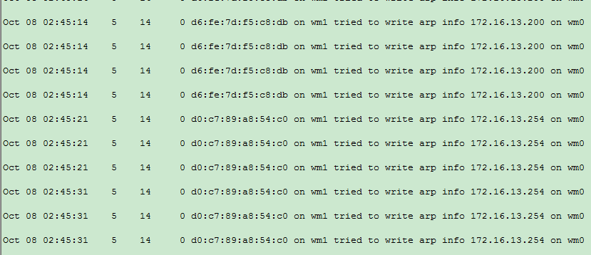

Hi
I have a device with two LAN ports, LAN1 is Intel 82579LM and LAN2 is Intel 82574. After update the driver(devnp-e1000.
so and enum file), both LAN can be found through ifconfig which are wm0 and wm1.
However, the LAN ports cannot work concurrently, if both LAN are connected to Ethernet cable with dhcp setting, both LAN
 can get IP but only LAN1 can be ping by remote device, LAN2 cannot be ping. Meanwhile, the system log would keep
showing "d6:fe:7e:f5:d8:db on wm1 tried to write ARP info 176.14.15.254 on wm0".
If I change it to static IP with different subnet, both ports can be ping but the "<some MAC> on wm1 tried to write ARP
info <some IP> on wm0" still shows up.
What should I do to solve this problem?
Thanks for help.
Attachment: Image sloginfo.PNG 27.41 KB
Re: Multiple LAN cannot work concurrently
That's not going to work. Each network adaptor needs to be attached to a different network. You are receiving the ARP
error messages because io-pkt is receiving an ARP response on one interface for a network that it thinks is attached to
a different interface.
What are you trying to achieve by plugging two network adaptors in to the same interface? If you are looking for
redundancy then the correct way to configure this is to create a bridge running STP with both interfaces as members in
the bridge, and then connect to a managed switch that also runs STP. The STP will cause traffic to pass over one link
and be blocked on the other. If the link passing traffic fails then STP will automatically switch to the other link.
If you are instead looking for increased throughput then the correct way would be to use LACP to a managed switch that
supports LACP. Unfortunately io-pkt doesn't support LACP at this time although it is a question we occasionally get
asked about. Please contact your support representative if you are interested in LACP support.
