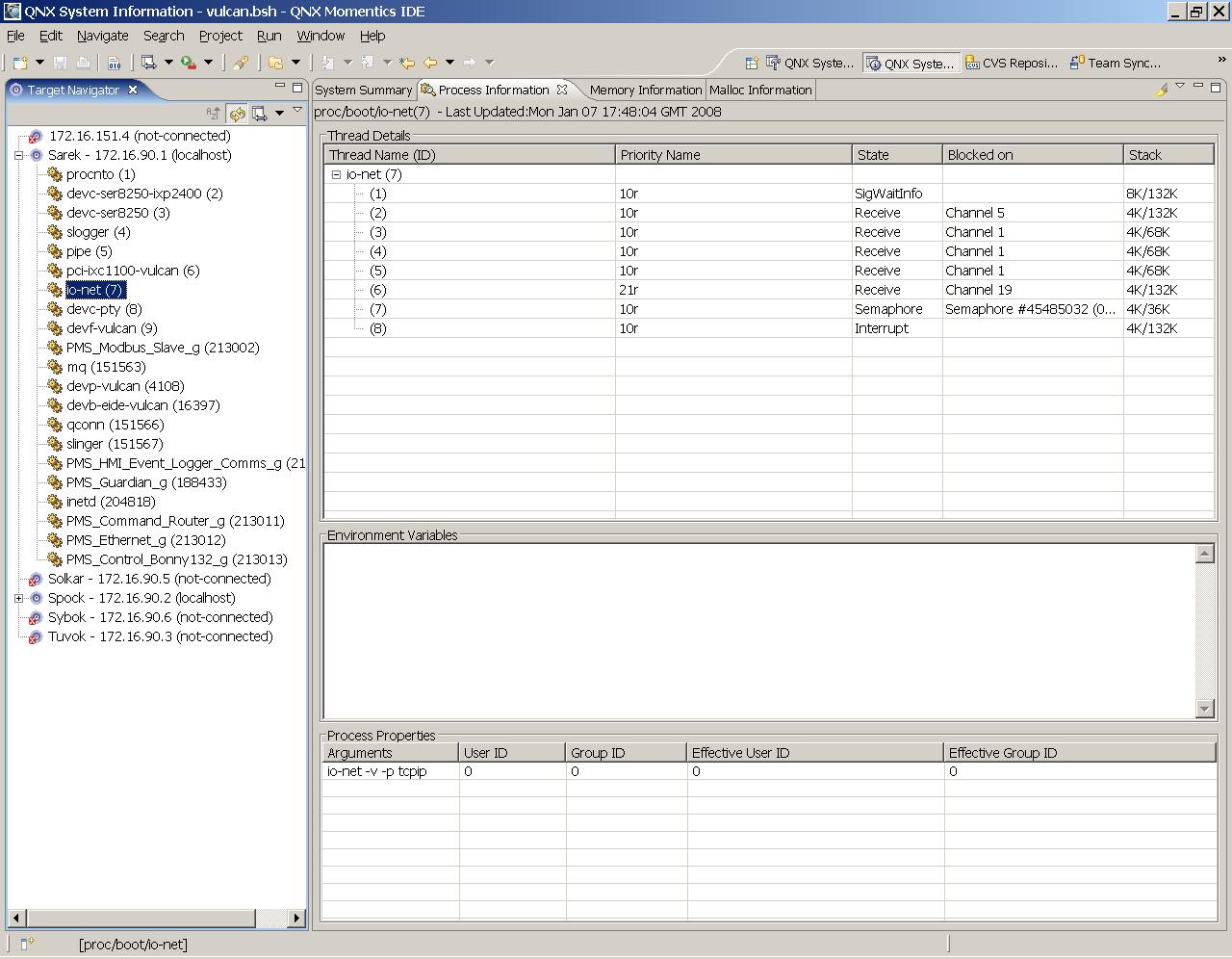

This is the way io-net is being started
io-net -v -p tcpip
mount -T io-net -o mac0=0080661026CA,mac1=0080661026CB /proc/boot/devn-ixp42x.so
io-net has 8 threads, one at priority 21 and seven at priority 10 (see attached).
What are the seven priority 10 threads doing?
Could there be a problem with our network driver?
Rich
Attachment: Image io-net.JPG 190.31 KB
Re: Prioritising Ethernet packets
> io-net -v -p tcpip
> Thanks,
> Rich
> Technology
> http://community.qnx.com/sf/go/post4093
Thread 1 is always only present to handle SIGINT.
I suspect thread 2 is the networking stack and
threads 3, 4, 5 are io-net's thread pool (handle
ops on entries under /dev/io-net).  It looks like
threads 6 7 8 are driver threads but it's unusual
to have the threads at prio 10.
-seanb
The thread that is semaphore blocked worries me - semaphores don't support
priority inheritance.
