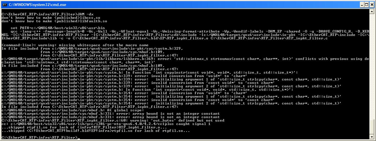

       We have all the binaries for 6.4.0 on which we are planning port ion-net to io-pkt. I am attaching the errors I
get which makes me feel that the header files and the binaries are in mismatch.
I am running a sample pfil code.
Can anyone please guess whats going on.

You're using c++.  The io-pkt + drivers + lsm headers
haven't been vetted for C++.
