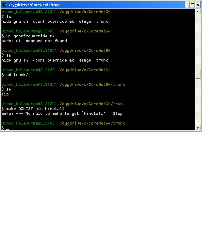

3. On the other spare machine I tried doing the full source checkout (with a pre-requisite of 6.4.1, which I installed
it on my PC) and I have executed the first 4 steps to build the source tree. The steps are given at below link.
http://community.qnx.com/sf/wiki/do/viewPage/projects.core_os/wiki/BuildTheOSSource
On the 5th step I am unable to execute "make OSLIST=nto hinstall ". I get an erro. I took a snapshort of my error and
attaching it in a jpg file. On this spare machine I also have older versions of QNX630 and 632.
4.But the ".metadata" folder is created in the build directory.

Re: pfil functions error
> 1. To build a io-pkt filter module, do I need to do such a huge exercise by downloading the fullsource tree and
buiilding?
That's actually not such a huge task. Try it, you might like it :-)
There's no makefile where you issue the make command. You need to
navigate down to lib/io-pkt.
/P
Hi Patrik,
             That is what I was thinking too, there is no make file except the "qconf-override.mk" I buiild with few
parameters as explained in the link below.
But the below links suggested I should build it from the build directory (which is the directory where I do a svn
checkout .
http://community.qnx.com/sf/wiki/do/viewPage/projects.networking/wiki/Source_Guide
Then according to you even the "stage" folder has to be created in io-pkt folder for the binaries to be put in there.

>  When I executed the
> below commands
> % cd <BUILD_ROOT>/trunk
> % make OSLIST=nto hinstall
> which are at step 5 in the "build the OS Source". There was nothing written into stage folder.  Don't you think there
should be some out put written into this stage folder at this point of time?
Again, since the repository has changed, the wikis aren't totally up to
date. You'll need to cd deeper into the trunk before starting your
build. First into lib/socket to hinstall its headers, then into
lib/io-pkt to build the stack. When you're actually building something
you'll see that the stage area builds up with header files and
executables and libraries.

I'm sorry about that. It shouldn't be that hard. Please try the steps
and checks I've outlined.
I just verified on a fresh checkout that it works for me. I only had to
create a Makefile.dnm in lib/io-pkt/sys/dev_qnx/e1000 directory because
of an outside dependency.
Hope this helps!
