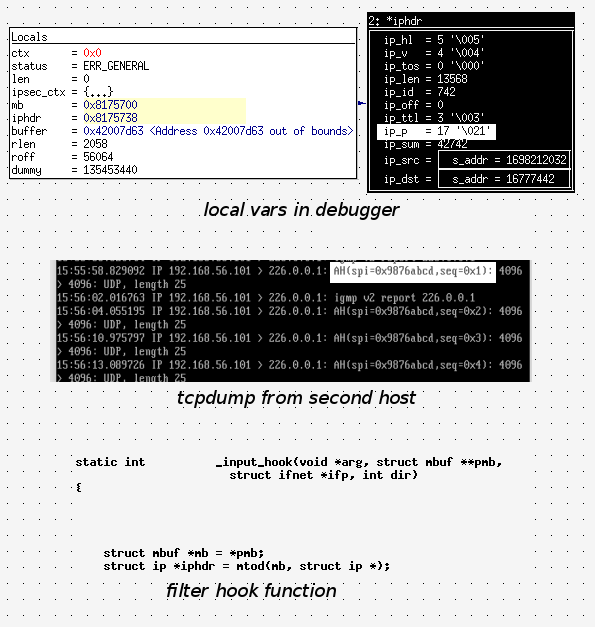

I have a packet filter that operates on AH-encapsulated UDP packets, and while tcpdump shows the AH header is there, it
is not available when my packet filter hook is called (at least, it isn't as far as I can tell.  The source and
destination are correct, but the ip_p field in the iphdr is only ever IPPROTO_UDP). I thought maybe something above my
hook in the stack was de-encapsulating the packet, but I haven't been able to find a way to test this. Any thoughts on
where I should look, or other possible causes?

Thanks again for the quick reply! I'm not enabling QNX's IPSec (and actually changed the startup io-pkt-v4-hc command to
 io-pkt-v4 to try to eliminate any additional behavior). I've attached a screenshot of the output I'm seeing, which
shows the AH packets, but in the input hook, ip_p is IPPROTO_UDP (17).  I think one thing I'm not unclear on is whether
or not something else in the filter chain is modifying the packet before my filter is called. Is there a way to view the
 actual chain? I tried some searching online but wasn't able to come up with anything that seemed to be what I was
looking for.  I feel like I'm missing something simple but can't pin it down.

Re: "Missing" IP headers and pfil order
The only way to see what is in the chain would be to walk the TAILQ yourself, see pfil_run_hooks() in the NetBSD code:
http://cvsweb.netbsd.org/bsdweb.cgi/src/sys/net/pfil.c?rev=1.28&content-type=text/x-cvsweb-markup&only_with_tag=MAIN
