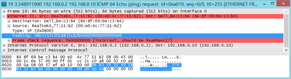

hello I have tried the command in qnx and wince ,and the result is not the same.
this is capture by the wireshark on qnx:
Attachment: Image ping from qnx.JPG 81.86 KB
Re: EtherCat Problem
What ping command were you using when you captured this? You also didn't
post the output from 'pci -v'.
On 2013-02-01 1:16 AM, "Fei Su" <community-noreply@qnx.com> wrote:
Because the frame  from qnx is fcs error ,and the wireshark put the fsc to me ,so we can see 4 bytes more than the frame
 from wince. But It seems like the 4byte are not fcs but padding.I guess that if we send frame less than 64byte(include
fcs) the driver will send the 4 padding data instead of the fsc.
Hi  the conclusion above is wrong. Just now, I use the fpga to analyse the frame ,found that qnx pad the frame to 68
bytes (include the fcs). The fsc error is mentioned by wireshark just because the impc protocl. So please help me to
check why qnx padding more 4 bytes?
