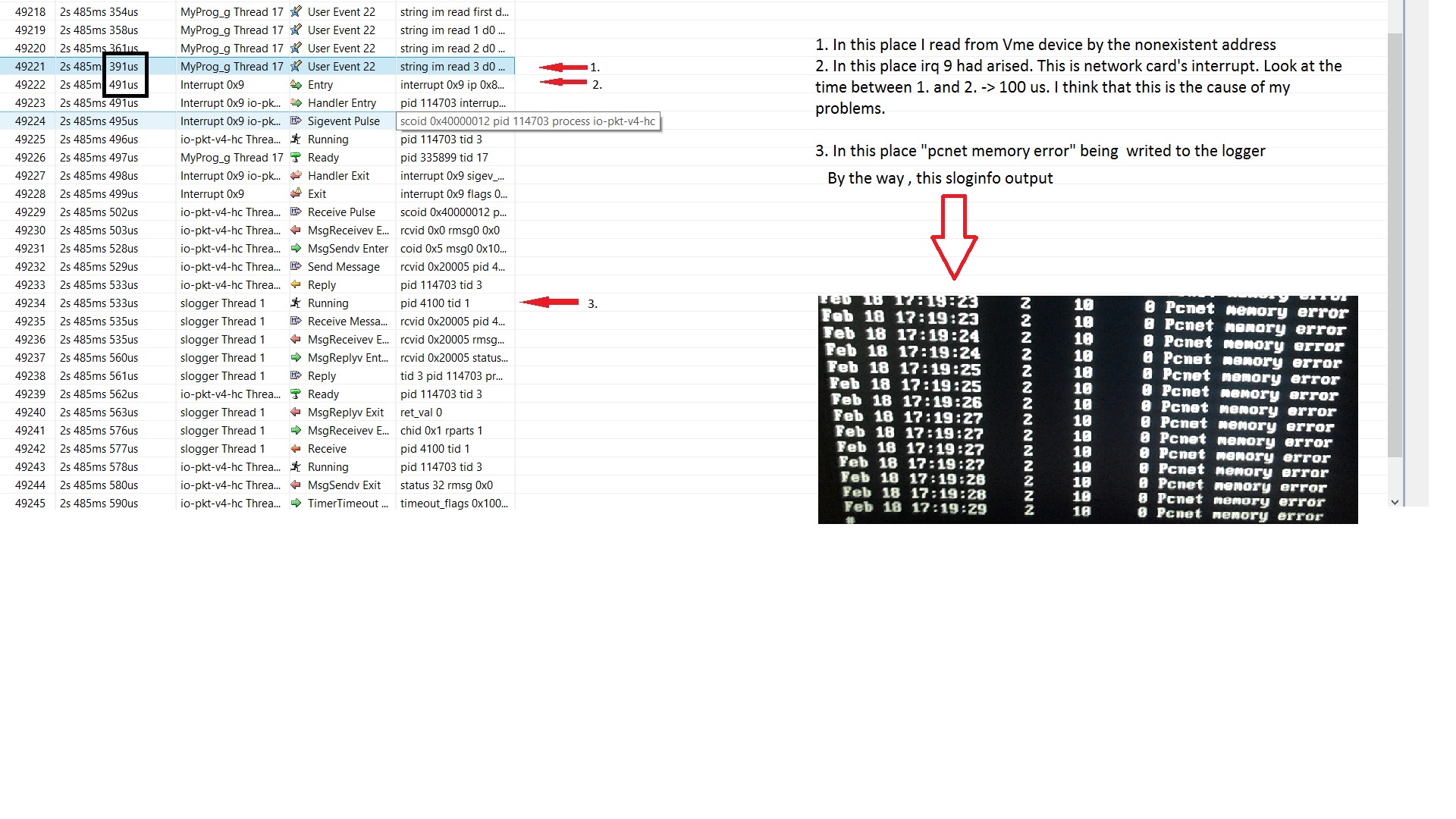

I had write kernel log. I attach tracebuffer.kev file.
I noticed another feature. If I invoke "sloginfo -w -c" then I have three times in second
message -> "pcnet memory error"

Maybe someone have pcnet32 network adapter sources. What is the case when "pcnet memory error" message generated??????
Re: Udp packet lost

You have a corrupted board sharing the same IRQ with io-usb -> that's
the best wayto loose interrupts.
io-usb is known for blocking/disabling its (shared) interrupt for a
longer time !
--Armin

But, Armin. How You conclude this??? You find out issue in tracebuffer.kev file??????????
I analyze tracelog and see that io-usb thread eat processor time only ~ 30us. Nothing criminal in that.

t:0xe875a9f0 CPU:00 INT_ENTR:0x00000000 (0)       IP:0xf007dbd6
t:0xe875ab69 CPU:00 INT_HANDLER_ENTR:0x00000000 (0)       pkt-mgr
IP:0x080b7a34 AREA:0x0812baa0
t:0xe875af0f CPU:00 INT_HANDLER_EXIT:0x00000000 (0) SIGEVENT:NONE
t:0xe875b1b2 CPU:00 INT_HANDLER_ENTR:0x00000000 (0)       PID:1
IP:0xf0052620 AREA:0x00000000
t:0xe875b545 CPU:00 INT_HANDLER_EXIT:0x00000000 (0) SIGEVENT:NONE
t:0xe875b82e CPU:00 INT_EXIT:0x00000000 (0) inkernel:0x00000001
t:0xe87d4ed9 CPU:00 INT_ENTR:0x00000000 (0)       IP:0xf007dbd6
t:0xe87d4ff7 CPU:00 INT_HANDLER_ENTR:0x00000000 (0)       pkt-mgr
t:0xe87d52e5 CPU:00 INT_HANDLER_EXIT:0x00000000 (0) SIGEVENT:NONE
t:0xe87d5527 CPU:00 INT_HANDLER_ENTR:0x00000000 (0)       PID:1
t:0xe87d597e CPU:00 INT_HANDLER_EXIT:0x00000000 (0) SIGEVENT:NONE
t:0xe87d5c2d CPU:00 INT_EXIT:0x00000000 (0) inkernel:0x00000001
t:0xe87d6313 CPU:00 THREAD  :THRUNNING     io-usb tid:5
t:0xe87d6468 CPU:00 THREAD  :THREADY       pid:1 tid:1
t:0xe87d8885 CPU:00 KER_CALL:TIMER_TIMEOUT/75 timeout_flags:0x00001000
ntime(sec):0
t:0xe87d8b05 CPU:00 THREAD  :THNANOSLEEP   io-usb tid:5
t:0xe87d8e4b CPU:00 THREAD  :THRUNNING     pid:1 tid:1
t:0xe884f46d CPU:00 INT_ENTR:0x00000000 (0)       IP:0xf007dbd6
t:0xe884f5e3 CPU:00 INT_HANDLER_ENTR:0x00000000 (0)       pkt-mgr
t:0xe884f90c CPU:00 INT_HANDLER_EXIT:0x00000000 (0) SIGEVENT:NONE
t:0xe884fb6c CPU:00 INT_HANDLER_ENTR:0x00000000 (0)       PID:1
t:0xe8850138 CPU:00 INT_HANDLER_EXIT:0x00000000 (0) SIGEVENT:NONE
t:0xe8850419 CPU:00 INT_EXIT:0x00000000 (0) inkernel:0x00000001

Armin, What is IRQ that shared???? I don't understand. In tracelog that you present I see that trigger IRQ 0 ( timer )
and scheduler change state of io-usb to RUNNING. And all.

Seems so that io-usb is using InterruptAttachEvent ??
>   And all.
  IRQ
   0:    IO-APIC-*edge*   timer
   1:    IO-APIC-*edge*   i8042
Only these interupts are active in your kernel trace ... I don't see any real PCI interrupts!
Is your Ethernet board broken ????????????
One of the shared interrupts is just the IRQ 0 ....

As you remember, USB subsystem is not interrupt-driven. Poll engine is the base of USB.
Io-usb simply wake up every 100 ms (as say tracebuffer.kev) and all. And I have no usb devices inserted to my computer.
Yes of course. "Pcnet memory error" message just overload (3 times in second) my slog. Therefore I lost packets.

Armin, I prepare some sweets)))))))
Please see to attachment.
Armin, what you say??????????
Attachment: Image Issue.jpg 519.63 KB
Re: Udp packet lost
Interesting !
Are there any hardware related delays or was the IRQ 9 disabled for lots
of us ?
Is the IRQ 2 used ? If yes, you shouldn't use IRQ 9 ...
--Armin
