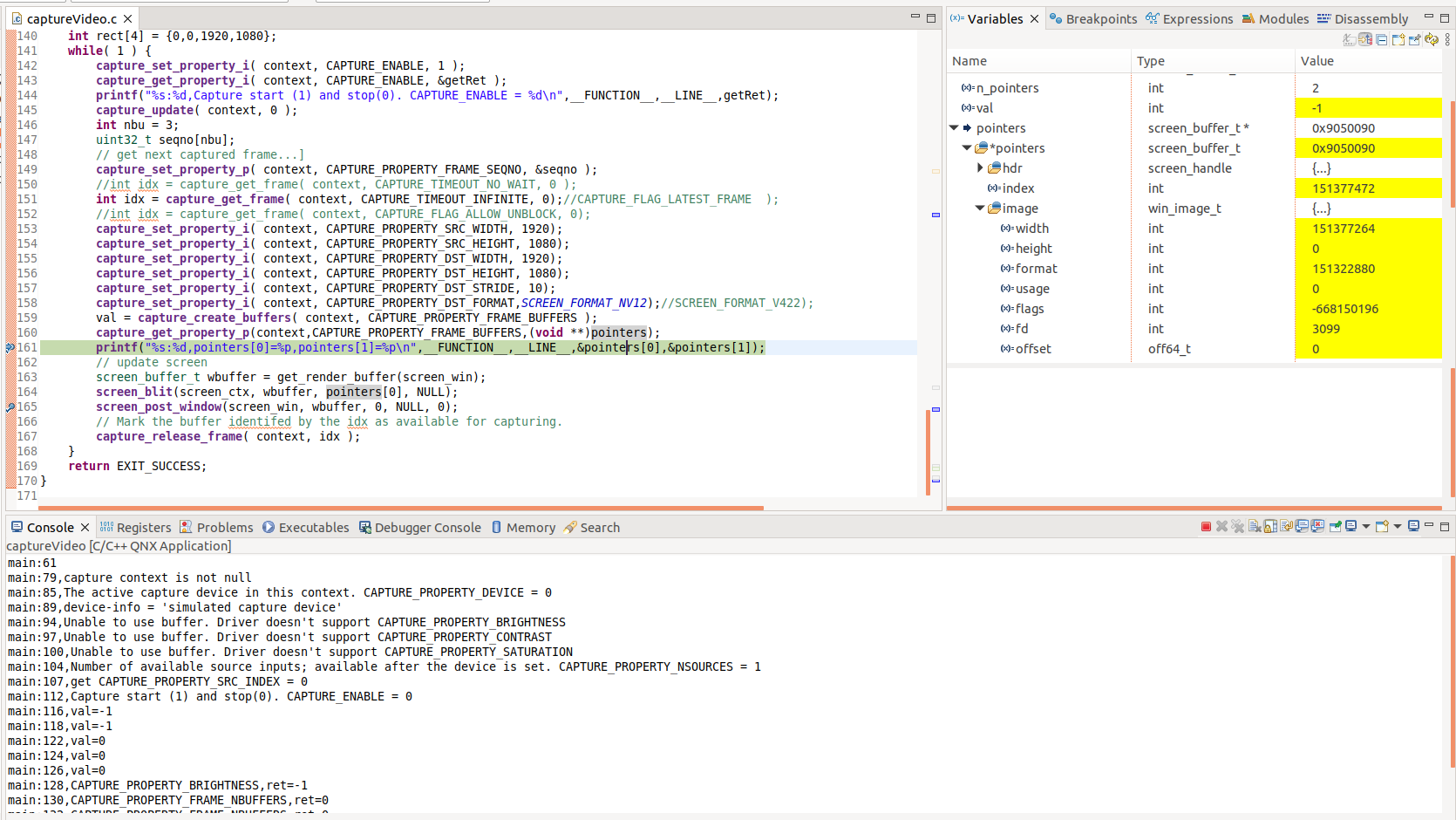

Can I use the sample video capture program to capture the camera stream?
https://www.qnx.com/developers/docs/7.1/index.html#com.qnx.doc.video_capture/topic/manual/vc_sample.html
But that was not work.
My test code:
int main(void) {
	int n_pointers = 2;
	screen_buffer_t *pointers = calloc(n_pointers, sizeof(screen_buffer_t));
	// connect to screen
	screen_context_t screen_ctx;
	screen_window_t screen_win;
	printf("%s:%d\n",__FUNCTION__,__LINE__);
	screen_create_context(&screen_ctx, SCREEN_APPLICATION_CONTEXT);
	screen_create_window(&screen_win, screen_ctx);
	int usage = SCREEN_USAGE_NATIVE;
	screen_set_window_property_iv(screen_win, SCREEN_PROPERTY_USAGE, &usage);
	int nbuffers = 2;
	screen_create_window_buffers(screen_win, nbuffers);
	int flags=0;//CAPTURE_BUFFER_USAGE_RDONLY;//CAPTURE_FLAG_EXTERNAL_SOURCE
	capture_context_t context = capture_create_context( flags );
	if( !context ) {
		printf("%s:%d,Handle errors:capture context is null\n",__FUNCTION__,__LINE__);
	}else{
		printf("%s:%d,capture context is not null\n",__FUNCTION__,__LINE__);
	// setup capture parameters
	int getRet;
	capture_set_property_i( context, CAPTURE_PROPERTY_DEVICE, 0 );
	const char *info = NULL;
	capture_get_property_p( context, CAPTURE_PROPERTY_DEVICE_INFO, &info );
	printf("%s:%d,device-info = '%s'\n",__FUNCTION__,__LINE__,info);
	int ret=0;
	// Validate device's properties
	if( !capture_is_property( context, CAPTURE_PROPERTY_BRIGHTNESS )){
		printf("%s:%d,Unable to use buffer. Driver doesn't support CAPTURE_PROPERTY_BRIGHTNESS\n",__FUNCTION__,__LINE__);
	if( !capture_is_property( context, CAPTURE_PROPERTY_CONTRAST )){
			printf("%s:%d,Unable to use buffer. Driver doesn't support CAPTURE_PROPERTY_CONTRAST\n",__FUNCTION__,__LINE__);
	if( !capture_is_property( context, CAPTURE_PROPERTY_SATURATION )){
			printf("%s:%d,Unable to use buffer. Driver doesn't support CAPTURE_PROPERTY_SATURATION\n",__FUNCTION__,__LINE__);
	capture_get_property_i( context, CAPTURE_PROPERTY_NSOURCES, &getRet );
	printf("%s:%d,Number of available source inputs; available after the...
View Full Message
Attachment: Image 2022-11-21 10_29_44-Ubuntu18_64.QNX - VMware Workstation.png 267.72 KB
