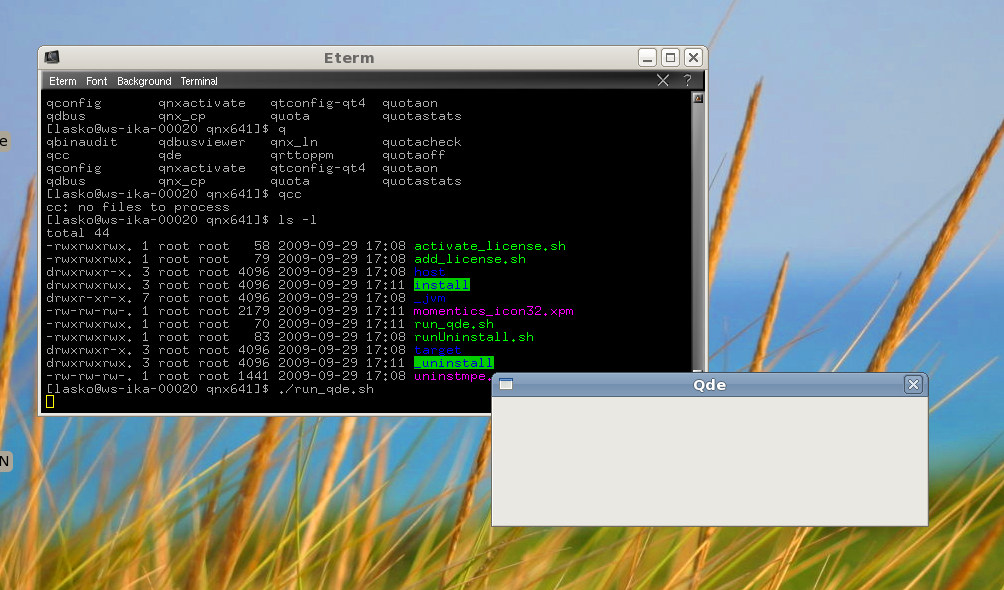

I had now reinstalled the QNX641 but the qde did not start.
See the attached screeshot.
Is there a logfile someplace.
/Lasse
Attachment: Image Screenshot.png 325.79 KB

Are you running FC11 in 64 bit mode? We have seen problems running IDE
on 64 bit systems because of some libraries fail to load.
Also can you try just type "qde" from your shell instead of running the
"run_qde.sh" script? The "qde" command is under your
"qnx641/host/linux/x86/usr/bin" directory.

No my system is a 32bit.
I tried to start the qde with just type the qde.
And i had tried to run the run_qde script. But nothing works
Is there a log somwhere like the installLog.txt?
/Lasse

RE: Cant install QDE 641
Since you haven't selected your workspace, the workspace log file has
not been generated.
You can type "qde -debug -consolelog". You should see the debug
information showing in your shell console.
BTW, FC11 is not a formally supported platform for IDE 4.6 (bundled in
SDP 6.4.1). You can download the latest IDE 4.7 from our forum download
site
http://community.qnx.com/sf/frs/do/listReleases/projects.ide/frs.ide_4_7
We have tested it on FC11 that IDE 4.7 works. You can always use it with
your SDP 6.4.1 installaion.

RE: RE: Cant install QDE 641
No, it's the Mozilla browser adapter issue which is in the Eclipse platform. We have seen this kind of problem with
newer Linux distributions. Updating to newer Eclipse platform will fix it - which you will do with the IDE 4.7.
Phab is for Windows only, you are running on Linux.

SV: RE: Cant install QDE 641
Yes you are right after a little bit of research i also found out of that :-)
But now i had downloaded the ide 4.7 and installed this in the qnx folder and now everything works for me :)
Thanks for your help.. :)
Now i just will enjoy my linux platform at code... :-)
/LAsse
