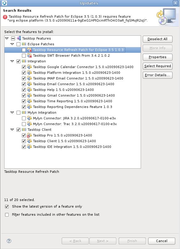

See attached file.  Notice how the "Tasktop Resource Refresh Patch for Eclipse 3.5 1.0.3" is unselected but there is
still an error.

Is it possible that this 3.5 patch is required by one of the feature
your selected? Can you check your IDE log file or post the log file here?

Re: Can't install pluging
The one that has an error now (in Client group) does it require 3.5?
In theory no, it's meant for both 3.4 and 3.5. They provide a different install site for 3.3.

Woops I lied, somehow the update site is the same whatever version of eclipse I use.  I just tried to install it on 6.4.
0 and no problem.  The difference is that it doesn't offer any option to install patches.  Looking at the id and
revision number of each components, they are the same whether I install from 6.4.0 (Eclipse 3.3) or 6.4.1 (Eclipse 3.5).

The problem seems to be coming from the tasktop side and not Eclipse.

> Subject: Re: Can't install pluging
> Mario Charest wrote:
> >> Screenshot?
> for Eclipse 3.5 1.0.3" is unselected but there is still an error.
> >> Are you using new installer (p2) or old one? Old one is less
> >> strict, it comes by default with Momentics IDE.
> > The old one, I thing.
> >> New one would be only if you install it manually (or update to
> Eclipse SDK).
> >> If you get plugins yourself you can just drop them in plugin folder
> and should
> >>  work theoretically.
> > Everytime I played with the plugin folder hell ensued ;-)  But will
> try since I seems to have no other option.
