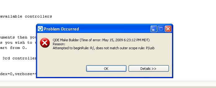

Thanks for your responses, I think I may have been a bit misleading.
It isn't that a compile error will be put into a dialog, but rather, if the managed build system or some non-gcc
produced error occurs during the build process, then a dialog is presented.
It did it a little today, but seems to have calmed down. Next time I get a sample, I'll post it.
Kevin
Re: Comipler Errors in dialog boxes
05/15/2009 8:44 PM
post29595
Found and example. Sometimes this appears and sometimes it doesn't, I guess it all depends how the stars are aligned
when I start the IDE.
Anyway, this dialog sometimes appears when I clean a project.
Kevin

Hi, Kevin,
This looks like a bug. The builder should not be attempting to lock the
workspace when it is building a project.
Can you provide a reproducible scenario, steps to follow? Perhaps your
workspace log file may have some entries before the error that can
provide clues. This would seem to be precipitated by some other
unexpected condition, which should be logged. Could you attach your
log?
Back to your original problem: Eclipse-based tooling generally does
alert via dialog boxes when user-initiated actions fail to complete
normally. Make errors are "normal" but failing to prepare to launch
make is not. It may be that some configurability of problem reporting
is appropriate, or that the workbench is treating operations as user
tasks that it should not. The workspace log of the error will help to
determine in which component we might look to address such concerns.
Cheers,
Christian

Hi, Kevin,
Thanks for the log file. It was illuminating.
The only way in which this particular problem can occur, is in projects
that are maintained in a source control system integrated with Eclipse's
Team framework. I see from your log that the Perforce team provider is
failing to initialize in the context of some common CDT model management
operations. Are the projects in which you get this build error managed
in Perforce?
If so, then it appears that the Perforce provider is requiring exclusive
access to the entire workspace in order to refresh a project, which in
the case of QNX-style projects, occurs on every build. The build runs
in a context that locks only the individual project.
This is a condition for which the QNX project builder can check in
advance, so I shall raise an internal enhancement request for that
change. Because our builder knows that it will require a refresh of the
project, it can check a priori the granularity of locking that will be
required in the workspace.
In the mean-time, I am unsure of how you can work around this problem
except by disconnecting your workspace projects from Perforce. I am,
frankly, surprised that this problem is intermittent; it appears that it
should always occur. Are there any particular actions that trigger the
error? My best guess at this point is that Perforce can provide finer
granularity of locking if it is correctly initialized, but that
otherwise the Eclipse default of requiring a workspace-level lock kicks
in and causes your build failures. Thus, the root cause would actually
be whatever is causing the CDT's internal model initialization to fail
in starting up the Perforce integration.
Cheers,
Christian

Hi, Kevin,
As I mentioned, I suspect that the problem stems from the Perforce team
provider failing to initialize on the projects in which this problem is
manifest, which then results in the default pessimistic locking strategy
being applied by the Eclipse platform in lieu of the defunct Perforce
provider. I would be extremely surprised if the Perforce provider,
itself, required a workspace-wide lock for refreshing a project under
its control: they would have had many complaints about that before now.
So, the question is what in the interaction between the CDT model
initialization and the Perforce team provider is causing the provider
initialization to fail? The log doesn't provide enough information.
Moreover, in your other reply, you mention that the error only occurs on
cleaning. Does a re-build (not from clean) work and show the results
that you expect? Are there any projects for which clean consistently
works? If so, how are they different?
Cheers,
Christian

Hey Christian,
One other item, it only happens when I clean a project.
Best,
Kevin
