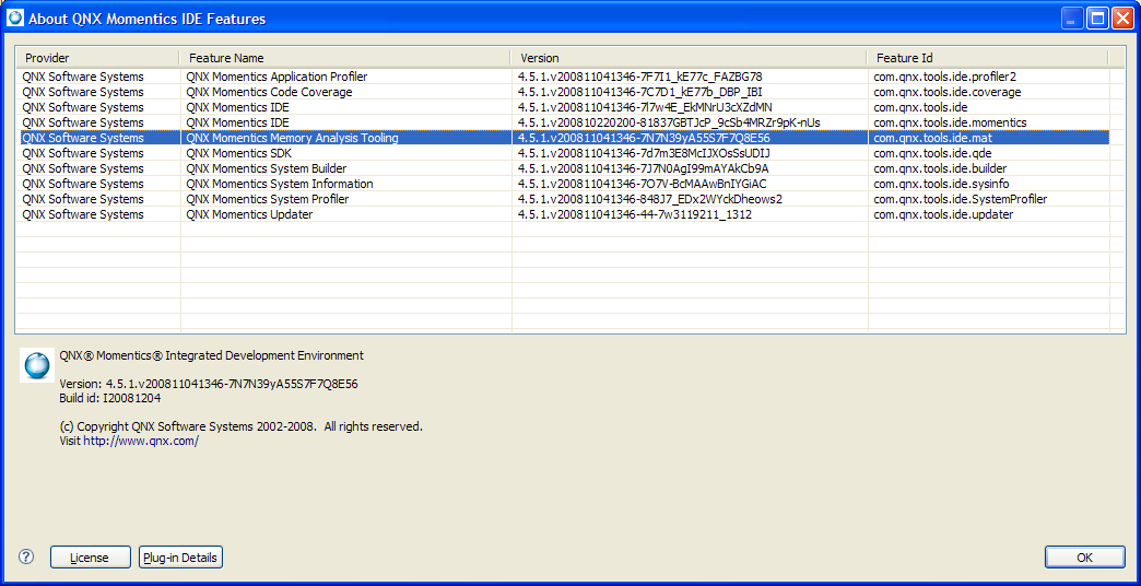

Re: IDE 4.5 creates useless efs images
02/12/2009 2:29 AM
post22058
Find attached my version info. Is it okay?
I have done the update through the IDE, should I try the zip file?
Thomas
02/12/2009 9:30 AM
post22082
Hold on, we need to investigate, maybe patch did not go through...

> Then tried to update (to get feature back) now IDE doesn't start anymore (see log).
> So should I remove everything and start from scratch?
> Thanks,
> Thomas
> http://community.qnx.com/sf/go/post22112
02/12/2009 11:22 AM
post22115
Yes I am on windows, and removing the config helped. But I am still not able to replace the builder just by replacing
the files? How to tell Eclipse to use the new one?
02/12/2009 11:24 AM
post22116
It should just use new one - if version is higher (which is). Check what plugins (versions) are loaded using Help->About
->Plugins-Details
> http://community.qnx.com/sf/go/post22115
02/12/2009 11:44 AM
post22120
It shows me old (no longer existing) version??????
02/12/2009 11:53 AM
post22125
It still caching it... Removing configuration area should have clean the cache.. Try start it from command line with
option -clean
> http://community.qnx.com/sf/go/post22120
02/13/2009 3:32 AM
post22178
Okay the Configuration Details tells me:
com.qnx.tools.ide.builder.core (4.5.0.v200809191301) "QNX Momentics System Builder Core" [Active]
com.qnx.tools.ide.builder.core (4.5.0.200902121038) "QNX Momentics System Builder Core" [Installed]
I tried to delete dth 4.5/configuration directory, no luck. Same with -clean.....
Any ideas?
RE: IDE 4.5 creates useless efs images
02/13/2009 8:14 AM
post22190
Can you move the 4.5.0.v200809191301 out of the "eclipse/plugins" directory and try again?
From: Thomas Wihl [mailto:community-noreply@qnx.com]
Sent: Fri 13/02/2009 3:32 AM
To: general-ide
Subject: Re: IDE 4.5 creates useless efs images
Any ideas?
General
http://community.qnx.com/sf/go/post22178
02/13/2009 9:50 AM
post22214
I made one with "v" in qualifier, that should work more smoothly if you just add it on top existing installation,
attached.
