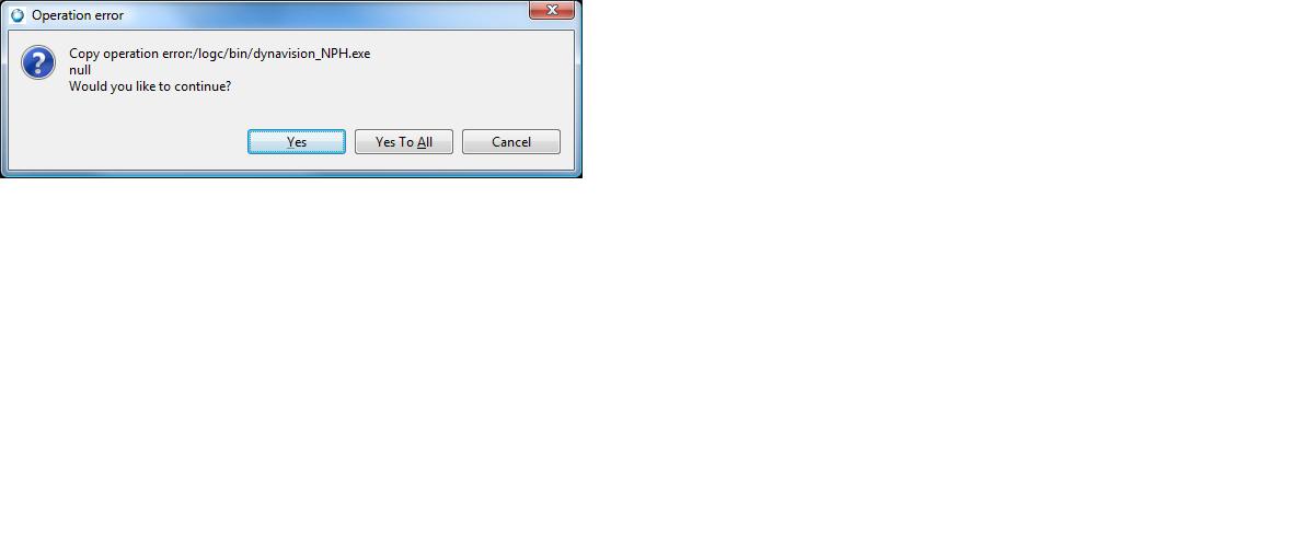

Hum, with this one  the behavior is different.
I select 10 files, then drap and drop them, but only the first file gets copy, no error messages.
Then I do the same thing again.  I get a dialog about ovewriting an existing files, that good. If I click yes, only that
 files gets copied.  If I click Yes To All then I can see on the target one more file got copy but then I get a copy
operation error ( see attach file).
Unfortunately qconn won't crash though.

Re: RE: RE: Target File System Navigator I20090205
found the problem. Introduced in new IDE 4.6 - it tries to copy files asynchronously creating various problems, I added
synchronization, will be available the next IDE 4.6 drop
