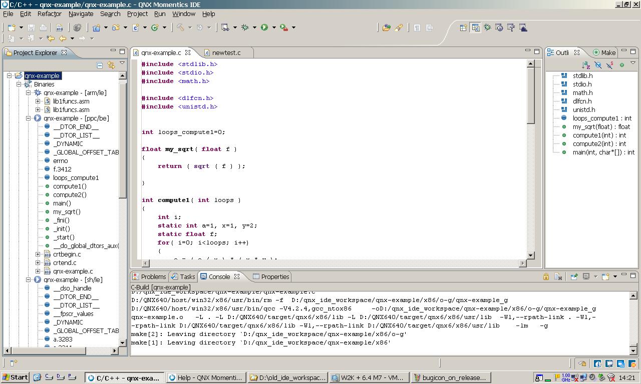

IDE 4.5, very simple QNX C project, compiled (for a test) for all platforms, release and debug.
Release binary has 'play' icon.
Debug binary has 'bug' icon.
However, in this case, the ARM release binary has the 'bug' icon. Even more strange, when hitting the little +, the
contents look pretty odd ('lib1funcs.asm' is in there only, but this twice). Other binaries have much more content (e.g.
 function names are visible).
I currently don't have an ARM platform so I can't test if the binary actually works.
What is wrong here?
- Malte
Attachment: Image strange_contents_of_arm_binary.JPG 170.8 KB

Pr this please. Something wrong with either binary parser or debug symbols.

Hm, there are 36 PR's from me still non-closed, shall I really file another one? Can't we have the existing ones fixed
first? ;-)
Anyway, I filed PR #63463 on this.
