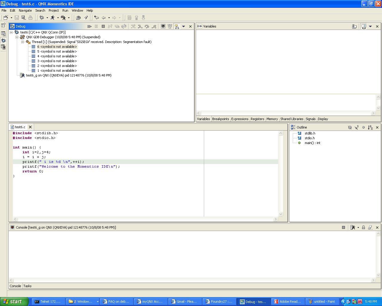

While following the steps to create a sample project as in quick start guide, the debugger is not coming to main and it
displays some message as shown in the attachment.
But if i run the code, it gives me the result.
please help

It seems to me that you try to debug release version of binary. Which
version of IDE are you using?

Looks like binaries does not match on host and target (i.e. libc binaries), what version of momentics is running on you
host and what is on your target?
