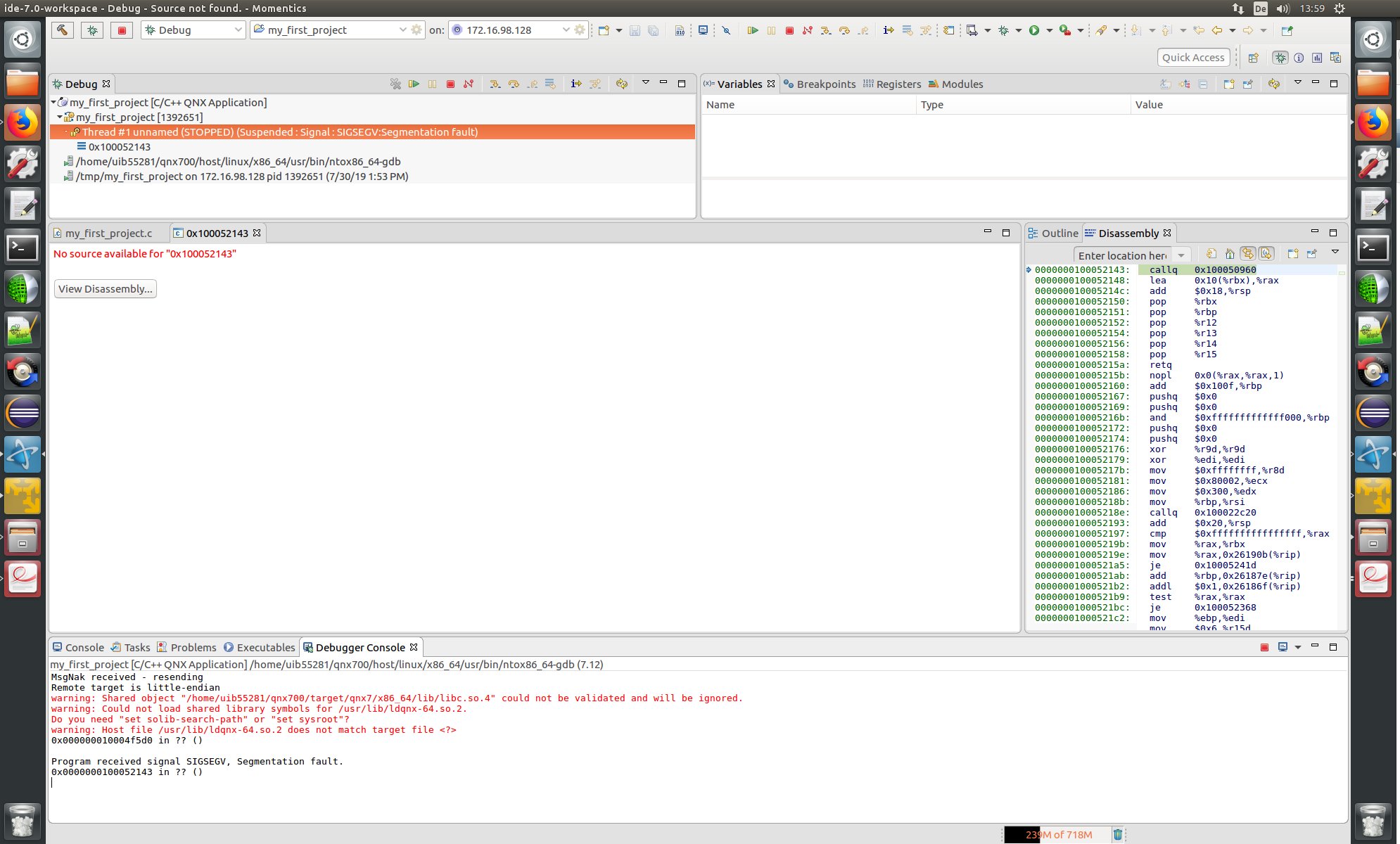

I am new to QNX. I have created a "Hello World" qnx executable project. I am debugging it on a target (qnx image loaded
via VMWare player). IDE is connected to target via qconn.
Running the program works. But when I am debugging, I am getting the below error.
Thread #1 unnamed (STOPPED) (Suspended : Signal : SIGSEGV:Segmentation fault)
Debugger console has following information. Please help.
MsgNak received - resending
Remote target is little-endian
warning: Shared object "/home/uib55281/qnx700/target/qnx7/x86_64/lib/libc.so.4" could not be validated and will be
ignored.
warning: Could not load shared library symbols for /usr/lib/ldqnx-64.so.2.
Do you need "set solib-search-path" or "set sysroot"?
warning: Host file /usr/lib/ldqnx-64.so.2 does not match target file <?>
0x000000010004f5d0 in ?? ()
Program received signal SIGSEGV, Segmentation fault.
0x0000000100052143 in ?? ()
Attachment: Image qnx_debug_error.jpg 324.8 KB

Re: SIGSEGV:Segmentation fault while debugging in QNX Neutrino target as a virtual machine
Target libc does not match host libc, its either mean its different
architecture or different version
Did you install debug symbols for libc? In software center right click
Install Debug symbols in Kernel & Libc package
Thanks for the suggestion. I just installed kernel and libc package via software center.
It is working now. I can debug.
