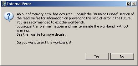

I don't see the .svn directories I the new project I created. That's
good news so I'm going to recreate my original project to see if it
fixes the problem. A second problem that I was seeing has become more
prevalent since I created the second project using subversive. I am
constantly getting "Internal Errors" any ideas on this one?

You run out of memory. How much you have on you machine? You need to add
options -Xmx700M -XX:MaxPermSize=128m to jvm launch.
If you running qde go to where it is located and find file qde.ini
there. Add these options in separate lines AFTER -vmargs (if they
already there increase mx one).

I have 2GB on my system. And this is how my qde.ini file was setup from
the IDE instillation.
-vmargs
-Xms256M
-Xmx512M
I bumped the -Xmx up to 700M
Thanks Mark

No difference I'm still getting the errors

The error is slightly different. I no longer get the first error, but I
seeing the "java heap space" errors.

I take it back.... It is a mix of both errors the "out of memory" and
"java heap space" errors together and the "java heap space" error by
itself.

Could you please send your .log file. You can find it in your work space
in .metadata directory
Alex

Can you try more memory? -Xmx1000M
> add
> > Mark reeder wrote:

Now try to start from scratch. Close IDE, rename your workspace
directory and start IDE once again (don't return back your qde.ini!),
connect to svn repository from SVN perspective and check out both
project. Does it help?
Alex

The IDE is running with no problems! Thanks for all of your help with
both issues.
Mark
