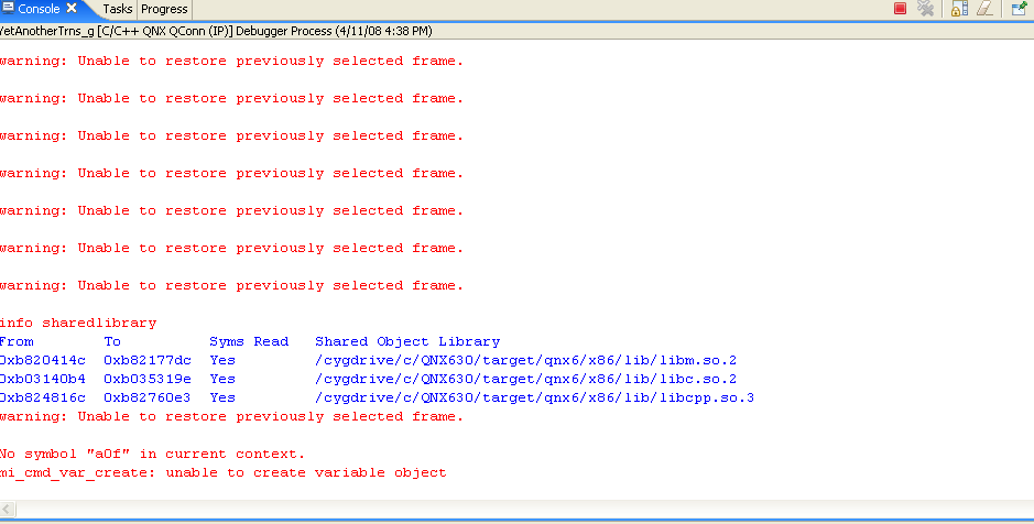

When i am trying to debug i get the following errors while debugging on QNX,
"No symbol "a0f" in current context.
mi_cmd_var_create: unable to create variable object".
i also get this warning: "warning: Unable to restore previously selected frame."
a0f is a variable that is not in this project. I clean build the project each time.
The application has single digit values are assigned to local float variables.
I see that while single stepping on the debugger these variables get NAN values.
Why I am getting these errors and warnings?
How can i eliminate these errors?
Thanks for your help.
Attachment: Bitmap console.bmp 1.28 MB

Could you give some info on your environment:
* What version of gdb are you using (you should be able to see it in the
gdb console, or by typing something like ntox86-gdb --version, or by
typing "show version" in your gdb console view when stopped at a breakpoint)
* What compiler version are you using?
Re: Errors: mi_cmd_var_create: unable to create variable object
The gdb verision that I am using is 5.2.1qnx-nto (got from the gdb console)
The compiler version is 2.95.3.
