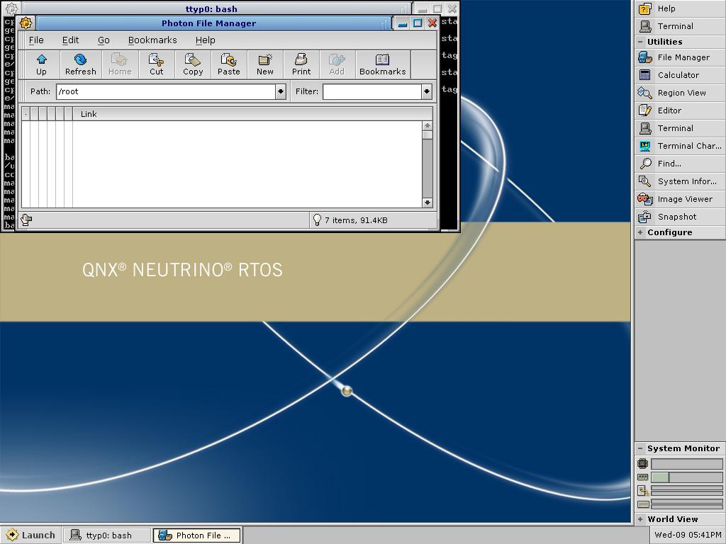

I am experiencing a problem with the photon interface. Indeed when the file manager is opened, it does not show anymore
the files which is very inconvenient to
manage files.I guess it is a trick with the configuration but did not manage to see where.
Attachment: Image snap1.jpg 87.16 KB

Re: problem with file manager
> manager is opened, it does not show anymore the files which is very
> inconvenient to
> to see where.
Does it help if You do the following:
close Your filemanager
in a terminal do:
cd $HOME/.ph
rm -Rf pfm
pfm
Something better ?
Hope this helps.
Jeevan
You 're genius Jeevan. It's all right now.
