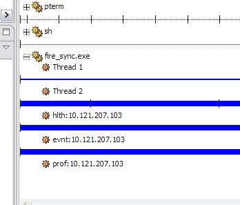

My program has 4 thread (including main).  3 threads are given a name ( thread 2,3,4).  Yet the timeline seems to be
confuse about this and although it displays the 4 threads, there are 5 names displayed.  See attached picture.
Using 4.5.0

There was a bug in the Trinity 1 release where it was releasing the
internal, 0 based thread id.  For later kernels (which I assume you are
running), it now emits
the public, 1 based, id.
But if you are still using an old IDE it will get the display wrong.
However see the thread of the attach message - I think you need to get
the latest build which I'm not 100% sure is there yet.
Colin

It may be fixed in next integration build, see post
"CPU Usage is reporting wrong threads"
