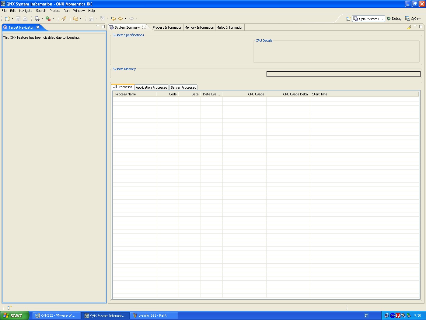

If you have the latest Momentics 6.3.2 and IDE 4.01 installed under windows, and are trying to do 6.2.1 development
under the latest IDE, do you need licensing information for QNX 6.2.1 as well as 6.3.2 in order to do the development?
As it stands if you change the active configuration to Momentics 6.2.1 and try to do development several problems arise.
 I attached a couple screenshots to show you what I mean.
Attachment: Image sysinfo_2_621.JPG 177.17 KB
Re: 6.2.1 development under Momentics 6.3.2 (IDE 4.01) in windows
On Windows, IDE 4.0.1 requires access to the %QNX_HOST%/usr/bin/qnxlic.dll library to validate the license. While you
change the $QNX_HOST to point to a different toolchain, you need to make sure your %PATH% env var has the path to the
Momentics 6.3.2 version of the "qnxlic.dll" so IDE 4.0.1 still can load the correct library.
On Linux/NTO, you can set the "LD_LIBRARY_PATH" env var to point to the correct library location.
