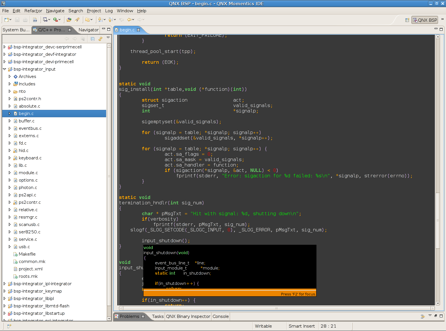

Re: Tau build (old build also) + mouse hovers
Here is a screen shot.
taken with ksnpashot this one shows input_shutdown (the function just below the cursor)
Attachment: Image snapshot1.png 198.13 KB

This is very weird.  There shouldn't be any black in your popup at all.  Are you using a special KDE theme at all?  At
you using a qt2gtk conversion theme at all?  The popup should be completely orange.
