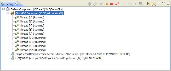

Hi -  I've done some searching on the site and in forums, and can't seem to find an answer to my question, so here goes
Why is it that the debugger perspective does not show thread names, rather it shows things like "Thread [1], Thread [2],
 etc"?  I saw a note that in 6.3.2 the debugger perspective in the IDE should display task names, it does not seem to be
 working for me in 6.4.1 (Momentics 4.6).
I feel like a total noob, but I didn't see anything about this anywhere on the qnx site...

Re: Getting the IDE to display thread names?
No IDE never showed thread names in debugger, because gdb does not support it by default (since thread name was not a
common concept across unixes). The only thing I can suggest that can help is to open another terminal to target using
Terminal view
and do "pidin | grep your_process" to see what number matches what thread name.

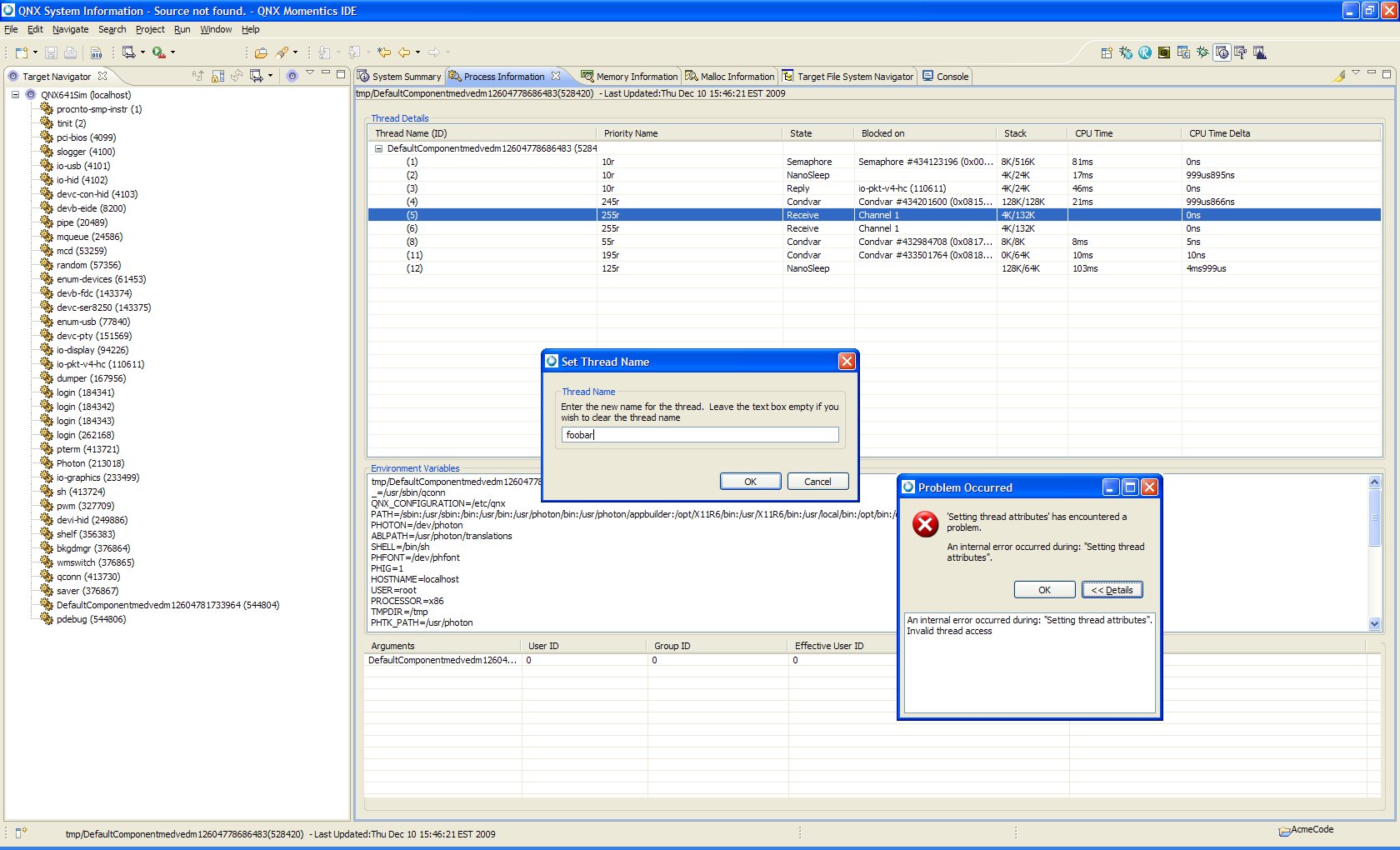

I can't seem to get the system information -> process information do what you think it should do.  It barfs if you try
to set the thread name, and it only displays IDs as well.
So in my view both of the last two lines are incorrect.
Attachment: Image debuggeryuck.jpg 271.57 KB
"Thread Name" is not shown by default in Process Information view, you
have to click the down-size angle at the upper hand side and select
"Configure", add "Thread Name" to the item to display.
So, yeah, you're right it was showing them for dev-eide.  I went back in my code and added a  pthread_setname_np() at a
spot I knew it would work, and this did show up.
So it seems like the best option I've got is to display the process information next to the debug tab and I should be
able to more easily correlate the two.
Right.  The IDE uses the Eclipse CDT debugging framework, which for
thread information tracks only a thread ID.  CDT doesn't provide the
means to track thread names.  Whether this is something that the
Momentics IDE could maintain and display for itself using its knowledge
of the capabilities of recent GDBs is an interesting question that would
take some offort to answer.

[Debug Process Information] would simply(?) be wired to trigger on selections from the [Debug] view rather than the
[Process Information] view.
It wouldn't be as neat as having the name information in the [Debug] view, but it might be an easier path than getting
the Eclipse CDT Debug view implementation modified, and it has the benefit of reusing the existing [Process Information]
 view with presumably a simple modification (the trigger). In a way, it would be equivalent to adding  [Process View] +
[Process Information] views to the Debug perspective, but
 - would acheive the same with one view (less clutter)
 - it additionally would "automatically" update when the user clicked a different process in the debug view, rather than
 having to find it in the [Process Information] view (tighter integration)
