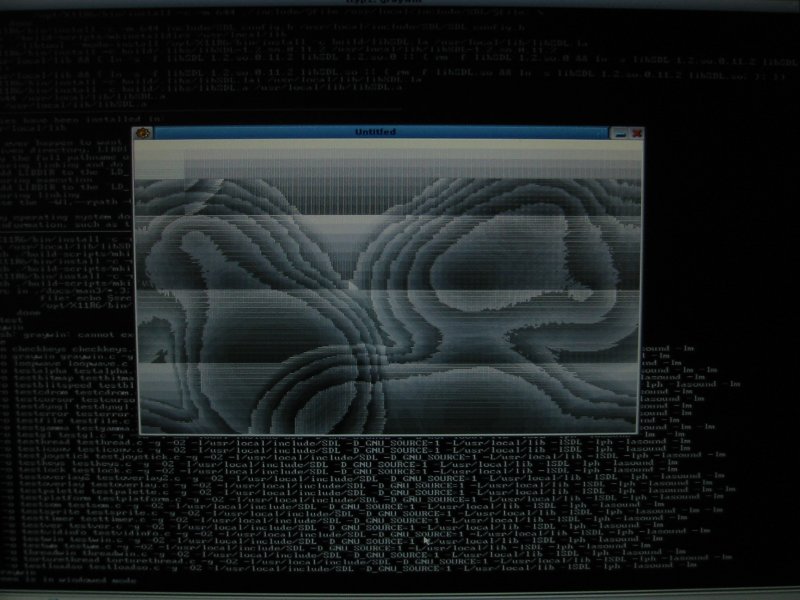

I have tested SDL 1.2.9 and SDL 1.2.13 on top of Photon/QNX 6.4 and got negative results.
For instance ... if you start the test example "graywin" ... the window of graywin is loosing at first its background.
Now it is possible to update that window with rectangles ... but if you hide that window by an other window and than un-
hide the window of graywin ... it is loosing all added rectangles and shows now only the background =:-/.
This problem doesn't happen with QNX 6.3.2. What is different with Photon of QNX 6.4 ?

Thanks ... after this modification most test applications are working now as expected.
Only the test app graywin has still a problem. It's the only one which is loosing updates of the window after a hide/un-
hide sequence.
I have tested this behavior on two different machines which are providing different VGA adapters.
The type of the graphics driver makes no difference.
Do you have any idea why these problems are not present with QNX 6.3.2 ?

regarding to point 2) ... iin the attachment is a small video which shows the problems with graywin.

Hm, looks like all rendering is done directly to visible display area instead of being rendered to offscreen area. Just
tested and got that under VMWare, svga, vesabios, tnt, radeon, i830, extreme2 all works fine, so I will ask you again
about the graphics driver, which one are you using ?

testpalette" was failing to create a correct window contents.
Best Regards
--Armin
PS: Misha ... I will send you a set of test apps and the shared lib of SDL 1.2.13.

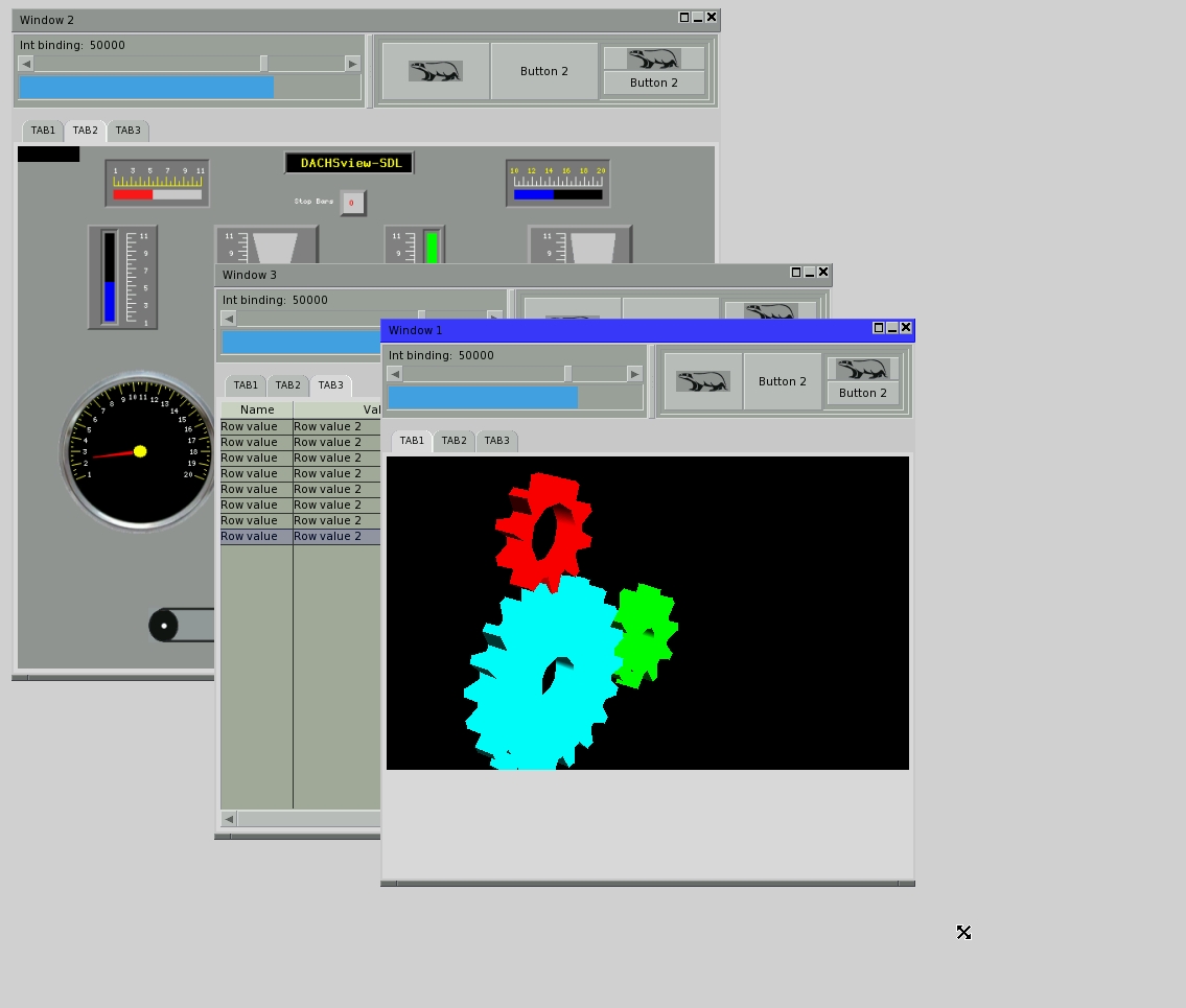

However ... I have tested now with 6.4.1: the modification of the cursor is now working, but the position of the
modified cursor is allways wrong. Please have a look to the attached picture. It shows the cursor after selecting the
right bottom corner of window 1.
Best Regards
--Armin
PS: this examole application has been developt with DACHSview:

Sorry, I didn't saw any cursor on the picture :(
As for position, are you sure, that hotspot displacements for the cursor image are set correct ? (The last two
parameters of SDL_CreateCursor() function).

The cursor is in the picture of the attachment .... not in the inlined picture. ( it should be only presented by a link
... sorry).
The hotspot displacement should be OK ... because of the same code works correctly under SuSE Linux.
--Armin
