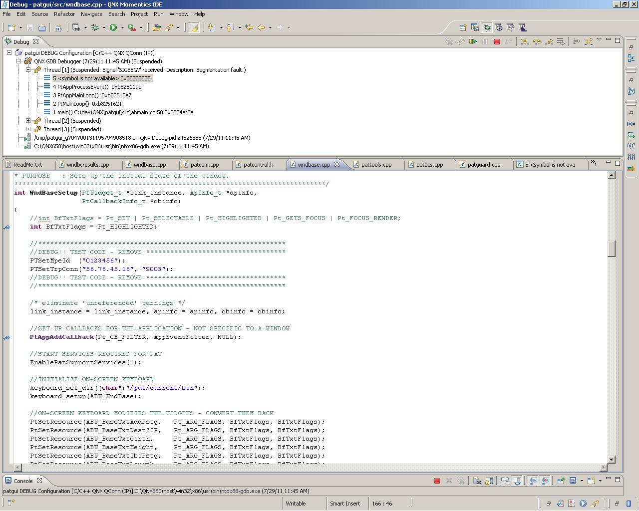

My application seg faults when I add the following code:
I am making the following call in the setup function of my main window.
PtAppAddCallback(Pt_CB_FILTER, AppEventFilter, NULL);
The prototype for AppEventFilter is:
int AppEventFilter(void* pData, PtCallbackInfo_t* pCbInfo);
The attached file shows the call stack and the Setup function where the PtAppAddCallback() is called.
Thanks for any help.

Re: PtAppAddCallback Issue
More information:
The application seg faults while it is starting up and before any windows are displayed.
Kendall
I think the problem is that  PtAppAddCallback() assumes that the callback uses the PtAppCallback_t structure, which is
not true for the Pt_CB_FILTER callback.  Try using PtAppSetResources() instead.
PtAppSetResource() solved the problem
Thank you.
