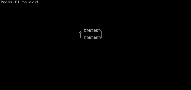

Will do, but I"m basically seeing '9's or 'q's on the horizontal bars (depending on which libncurses I linked against.)

Here's a screenshot. The figure in the center is supposed to be a box. This was taken on a new installation of 6.5.0,
but it is identical to the 6.4.1 test I ran before. Does this look like the repeating character problem you mentioned?
Attachment: Image snap1.png 1.67 KB
Re: pterm charset
Yes it is the problem. It is fixed in the head. You can sign-up to get the source: http://community.qnx.com/sf/wiki/do/
