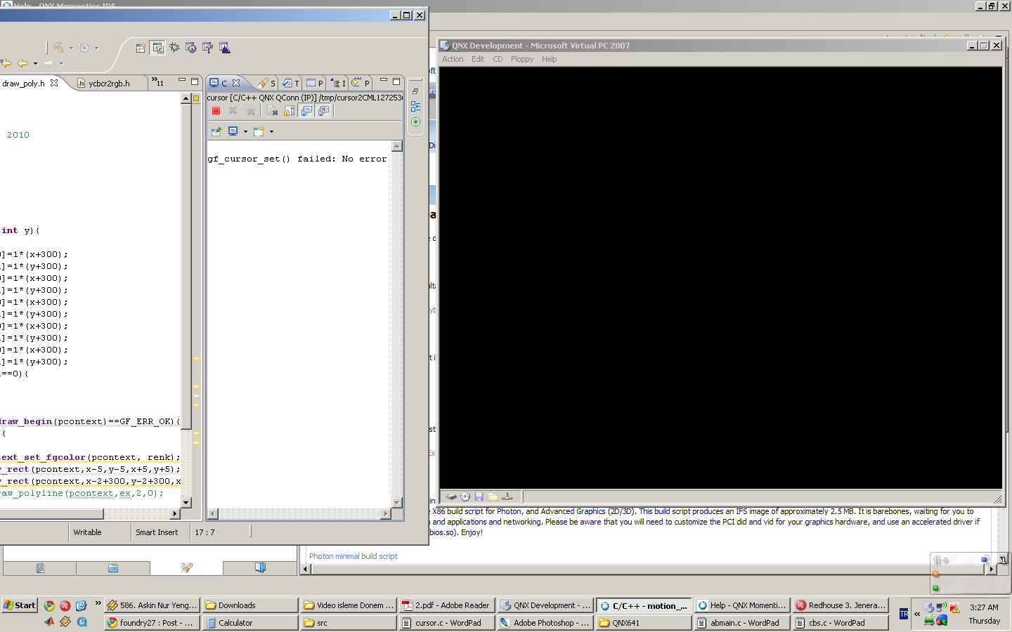

Hi derek,
I studying your demo but I can't any curson on screen?
Code running.
is there any configuration for this project?
because I can't open downloaded file.
I copied text to new project and then compiled,

Are you running io-display?
Have you enabled the layer, and called gf_layer_update()?

Just to clarify, what devg driver are you using?
Can you please post your code, with the parameter calls?
thx.
Re: RE: RE: RE: Can't set cursor shape using gf_cursor_set() function
04/30/2010 6:07 PM
post53361
gdev_info.description = vesa - unaccelerated driver for VESA 2.00 compliant adapters
is this which you want?

Yes! That is the problem, devg-vesabios does not have a hardware
cursor. Photon makes a cursor for software by drawing it by itself, but
GF does not have any support for a software cursor.
I suggest using an driver that has a h/w cursor, if available, or you
will have to create routines to draw a s/w cursor. Of course, maybe you
could write the application in Photon?
