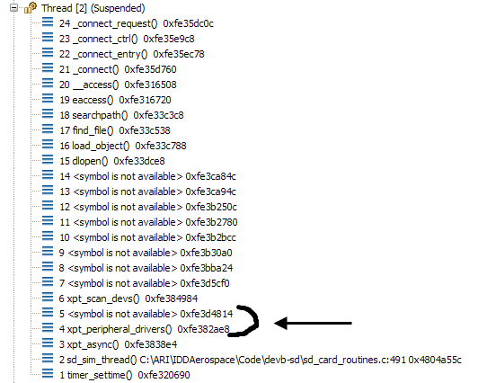

Re: io-blk, rmvpoll and automount
Well, I'm not out of the woods yet.
Attached is a stack trace of one of the steps xpt_async( AC_FOUND_DEVICES ) takes during it's lifetime.  Notice the <
symbol is not available> between xpt_peripheral_drivers() and xpt_scan_devs().  Something is clobbering the stack.
My first inclination is to take a close look at what I'm doing in Path Inquery and sd_inquiry to sure I'm not doing
something bad there, but they are rather simple functions...
Any insight or ideas would be great.
Kevin

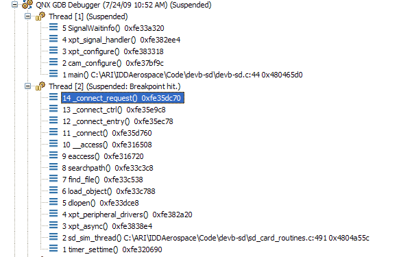

Hmmm, everthing is good up to )_connect_request
Attachment: Image Stacktracegoodtoconnectrequest.PNG 21.93 KB

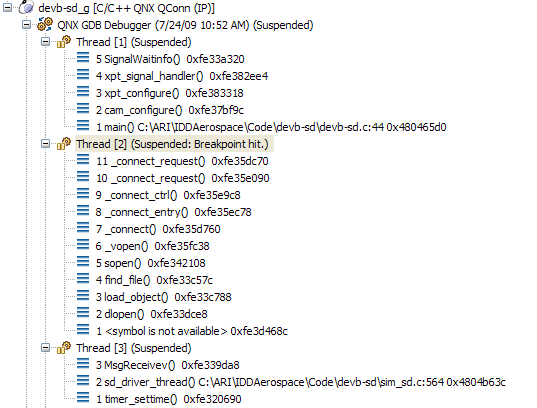

Source code to _connect_request() is available!
_connect_request() looks recursive, and while I only see it going one deep so far, the stack is already taken a beating.
I've got 10k of stack space, is this not enough?
I'll try 100k and see if that works...
Attachment: Image StackCorruptionBegins.PNG 23.83 KB
Success!
I did 64k and that did the trick!
Thanks for allowing me to ramble
Cheers
