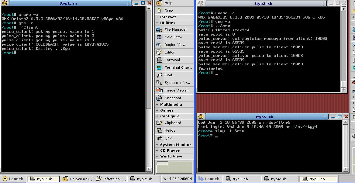

my client:
[snip]
   /* look for server */
    server_coid = name_open( RECV_NAME, NAME_FLAG_ATTACH_GLOBAL );
    while( server_coid == -1 )
      sleep(1);
    /* We want to be notified when the server goes away.*/
    chid = ChannelCreate(_NTO_CHF_COID_DISCONNECT );
    if( -1 == chid)
        perror( PROGNAME "ChannelCreate");
        exit( EXIT_FAILURE );
    self_coid = ConnectAttach( 0, 0, chid, _NTO_SIDE_CHANNEL, 0 );
    if( -1 == self_coid )
        perror( PROGNAME "ConnectAttach");
    msg.type = REG_MSG;
    /* Initialize the sigevent structure (msg.ev) in the message
     * to be sent to the server.
    SIGEV_PULSE_INIT( &msg.ev, self_coid, getprio(0), MY_PULSE_CODE, 0 );
//send something to the server
    if (MsgSend( server_coid, &msg, sizeof( msg ), NULL, 0 ))
        perror(PROGNAME "MsgSend");
    while( 1 )
        rcvid = MsgReceive( chid, &recv_buf, sizeof(recv_buf), NULL );
        if( -1 == rcvid )
            perror(PROGNAME "MsgReceive");
            continue;
        if ( 0 == rcvid )
            /* we received a pulse, often a side-effect of using name_attach()
             * we need to deal with the system pulses appropriately
            switch( recv_buf.pulse.code )
                /* system disconnect pulse */
                /* our pulse */
                case MY_PULSE_CODE:
                	printf(PROGNAME "got my pulse, value is %d\n", recv_buf.pulse.value.sival_int);
                	break;
                case _PULSE_CODE_COIDDEATH:
                	printf(PROGNAME "COIDDEATH, value is %d\n", recv_buf.pulse.value.sival_int);
                	printf(PROGNAME "Exiting ...Bye\n");
                	exit(0);
                	break;
[snap]
attached a picture.
Jeevan
Attachment: Image ServDeathDetection.JPG 116.18 KB
Re: Getting info about remote process death with a channel/connection
Jeevan, thanks it seems to work.
But I'm wondering a bit because it essentially contradicts the manual...
