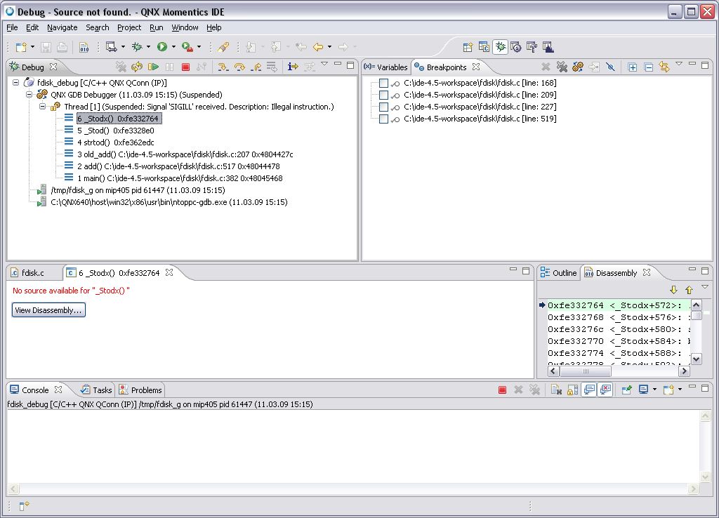

Please take a look at the attached fdisk debug session.
fdisk was started with the following parameters:
fdisk /dev/hd0 add -t 77 -p 50

Problem with floating point?

Good shot Mario !!
Indeed our target doesn't have FPU unit and now with fpemu library everything is ok.
Thank's
