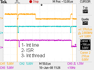

We use interruptAttach() to attach a ISR to the interrupt line. When the system registers an interrupt, the ISR sends
and event to a Int_Thread that handle the interrupt at a lower priority. Since the card generates an interrupt every 125
µs, we measure the time distance (by generating a pulse to the parallel port and sending the signal to a scope) between
 two successive interrupts that the Int_Thread receives. At this point we notice that some Interrupt are failing
(distance 250 and 375 µs).
After further debug operation, we noticed that the ISR a times sends the event to the Int_Thread with a delay of up to
200µs. furthermore we notice that execution of the Interruptunmask() function int the Int_Thread also occurs with delay
 (ca. 300µs) at times. This leads the system to remain in an interruptmask state for some 100 µs and no further
interrupt can be registered.

Attachment: Bitmap Error_ISR_notActivated.bmp 18.05 KB
