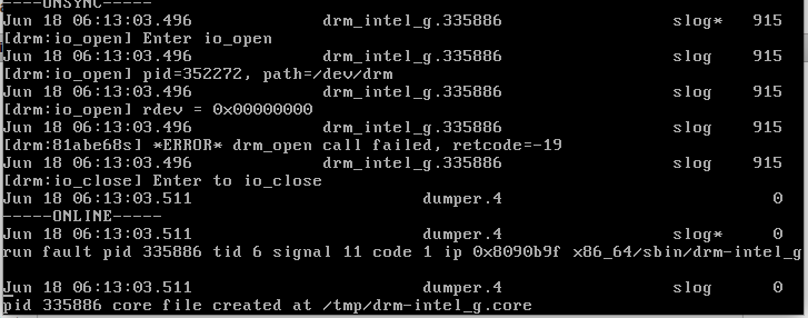

I'm trying to run screen in in QNX Neutrino 7.0. I have the desired qnx neutrino image running in qemu with a GPU (Intel
620 UHD) passthrough for development purposes. Before trying to launch screen, that is also crashing, I'm trying to run
drm-intel and drm-probe-displays.
There is no problem with the first one (drm-intel).
However, drm-intel completely crash after running drm-probe-display. By examinatin the logs, seems as if the GPU is not
supported.
See qemu_drm-intel_crash.png for the logs.

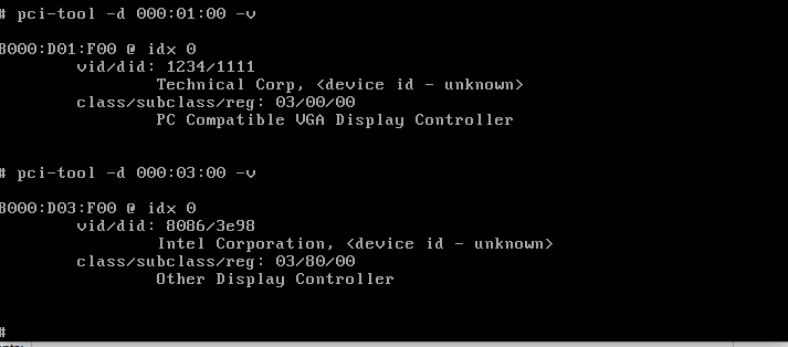

When checking pci-tool I'm able to see two GPUs or at least two display controllers.
See qemu_graphic_controllers.png for the output of pci-tool regarding those devices.
I was expecting the Intel board to be in charge of main display. However seems that drm-intel is crashing because the
device managing display is not supported by drm-intel. Any idea about how can I solve this issue?
