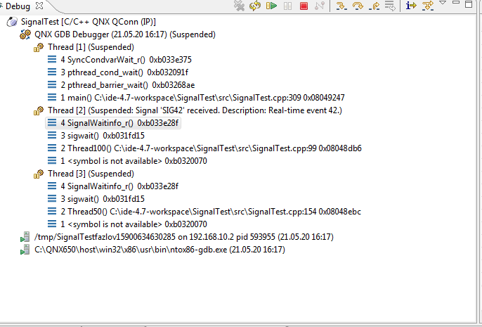

The thrrad is waiting for a signal from the timer ( sigwait (&set, &sigw);). When the timer signal arrives, the thread
must perform certain operations (I have an increased counter). If you use special sigrtmax + 7 or SIGRTMAX + 8 signals
in the task, the task is completed. If you use real-time signals SIGRTMIN+1, SIGRTMIN+2, the task is not performed. the
Threads go to SUSPEND mode and work only when you click the RESUME button. (see the screenshot )

Re: Question about synchronization of real-time threads by signals.
If you run under the debugger, then it catches all signals by default. Try to run your program szand-alone on the target
. Does it work then?
