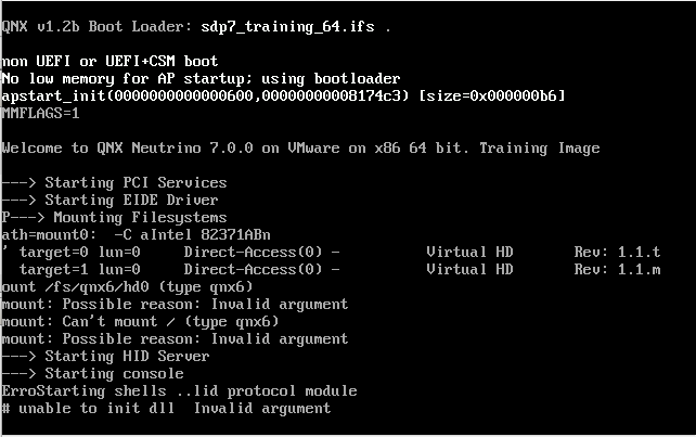

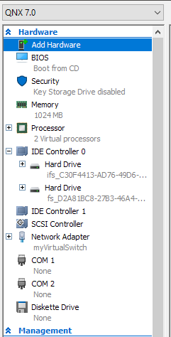

I managed to transfer the two VMDKs in VHDXs. However, I'm now stuck in the Hyper-V part and orchestration of the drives
. The picture I attached showed where it failed. I took great care to copy any relevant information from the.VMX and
tried my best to convert it into Hyper-V settings.
I also tried booting with AP (whatever this means) without any success (but different error messages)
Thank you

What does "ls /dev" show?
