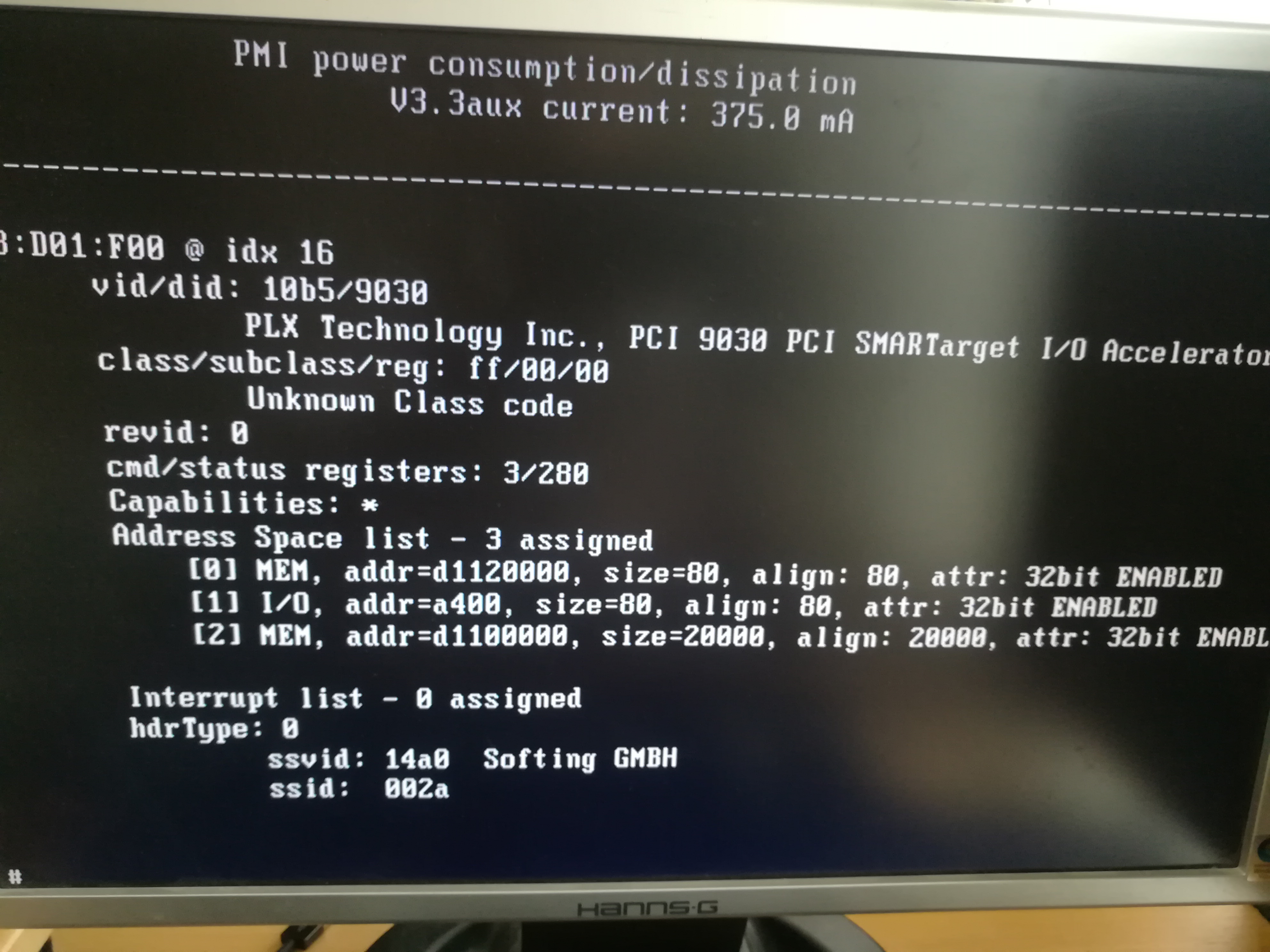

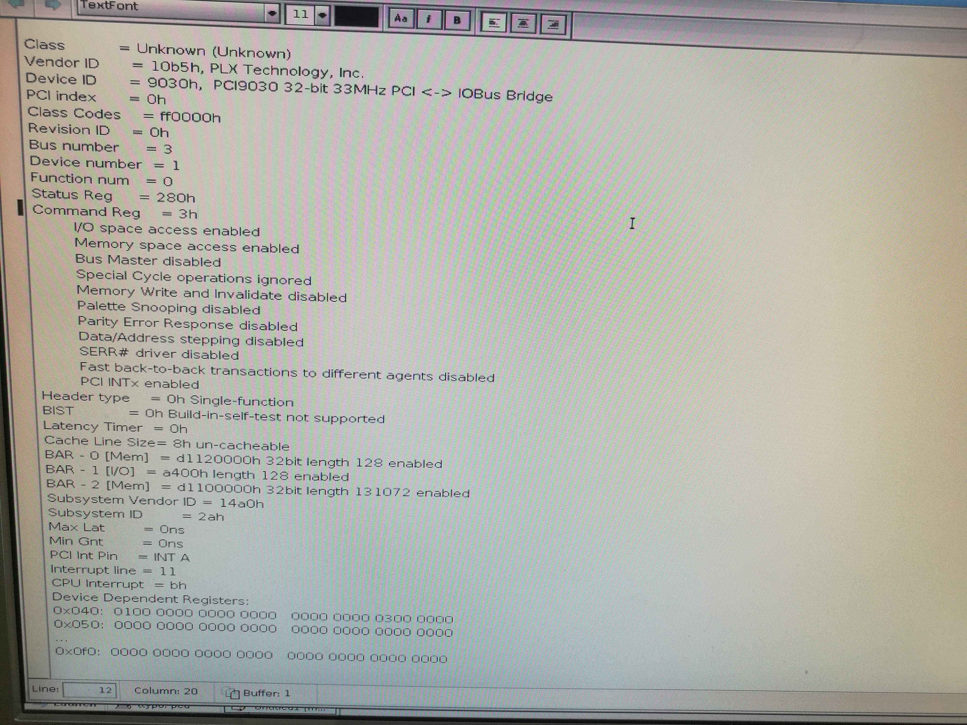

Re: PCI 2.x devices not supported by QNX 7.0
Hi Mike,
yes, the problem are the "old" PCI2.x cards. Please have a look to the different screendumps for QNX 6.5 and QNX 7.0 ...
 they are attached.
Regards
Armin
Ok ... in order to support 32-bit PCI 2.x adapter for QNX 7.0 I'm going to develop my own  64-bit PCI server.
It will be just a standard resource manager dealing only with 32-bit PCI card bus adapter.
Armin Steinhoff
First results are attached ... it's the 64bit version of lspci ... its code base could be the base for the PCI server.
