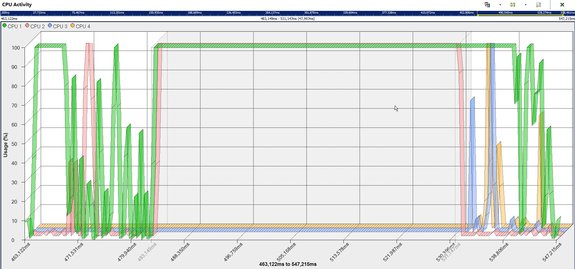

CpuActivity.png shows that CPU 1 and 2 are at 100% while CPU 3 and 4 are at 0 % during the whole time slot.

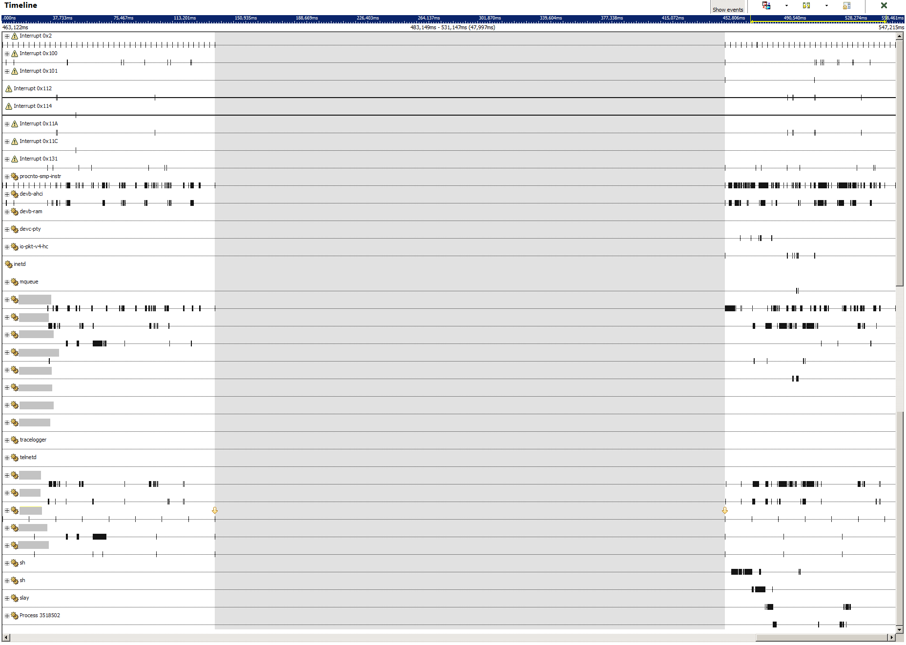

TimelineOverview.png shows an overview of all running processes. There are no entries during the 48 ms time slot.

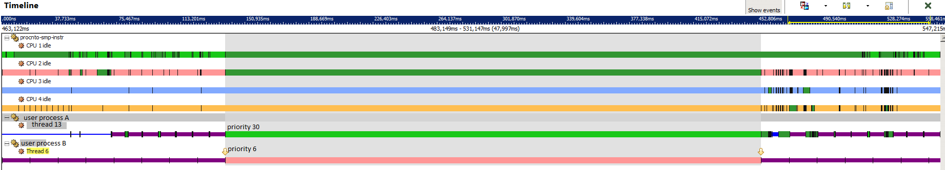

TimelineDetail.png shows the CPU 1 to 4 idle threads and two user threads which are running on CPU 1 and 2. Again there
are no events in that time. The two user threads run on relatively low priority (30 and 6). Blocking by priority cannot
be the root cause of the freeze.

Note two cores don't run during that time (likely one).  The timeline shows two because two cores were running before
and after control was taken away from the o/s.
