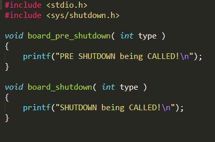

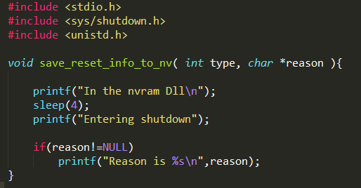

Can you post your code, along with the way you're setting BOARD_SHUTDOWN_DLL?
Re: Shutdown dll
I'm assigning the DLL as
BOARD_SHUTDOWN_DLL=shutdown_test.so
or BOARD_SHUTDOWN_DLL=shutdown_test in the command line
I'm trying to test it both the ways
I've attached the codes for both shutdown_test.so and shutdown_nvram.so
Attachment: Image 2018-07-20_10h28_59.png 10.2 KB Image 2018-07-20_10h29_19.png 9.22 KB
Re: Shutdown dll
You need to export the environment variable, so that your shell's children get it too:
export BOARD_SHUTDOWN_DLL=shutdown_test.so
Re: Shutdown dll
Thanks a lot Steve! It's working :)
Re: Shutdown dll
You're welcome. I've added a few more details to the documentation to make it easier for others who need to do this.
