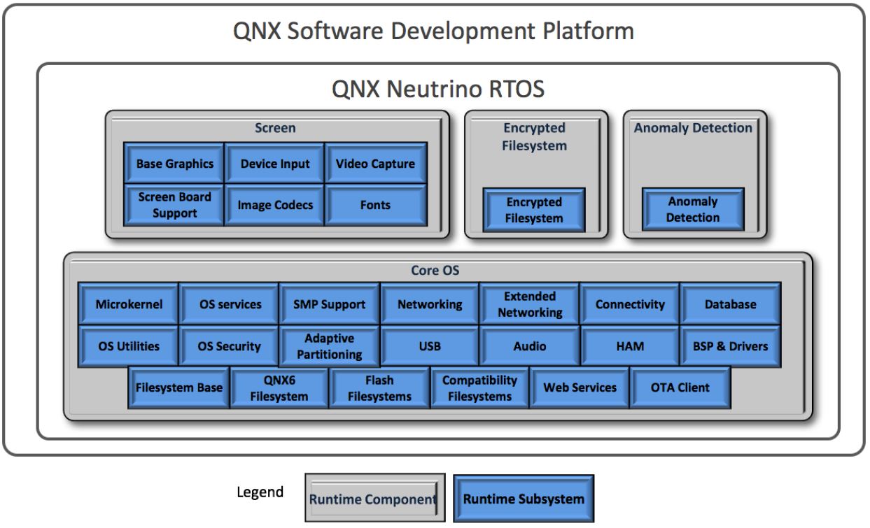

Is qad a native module of QNX OS?
Re: qad crash - Process 421917 (qad) terminated SIGSEGV code=1
yes, it is.
Attachment: Image QNX_SDP_Architecture.JPG 135.11 KB
