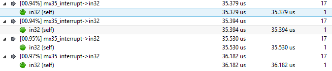

In file image001.png, the figure shows the in32() is called a total of 17 times and has 35.37us as total time, this
translates to 2.08us per in32().
The other tests shows up-to 2.5 us to execute this function.
