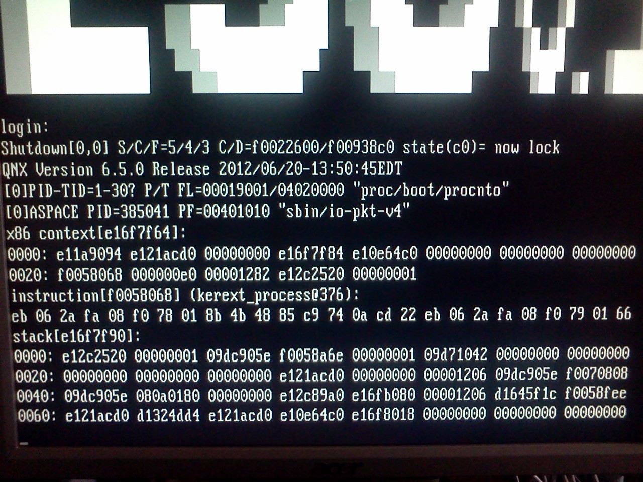

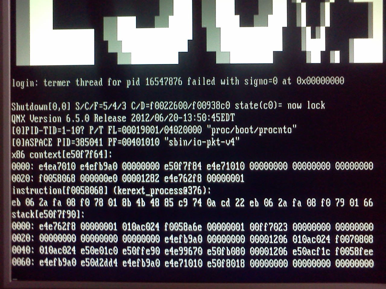

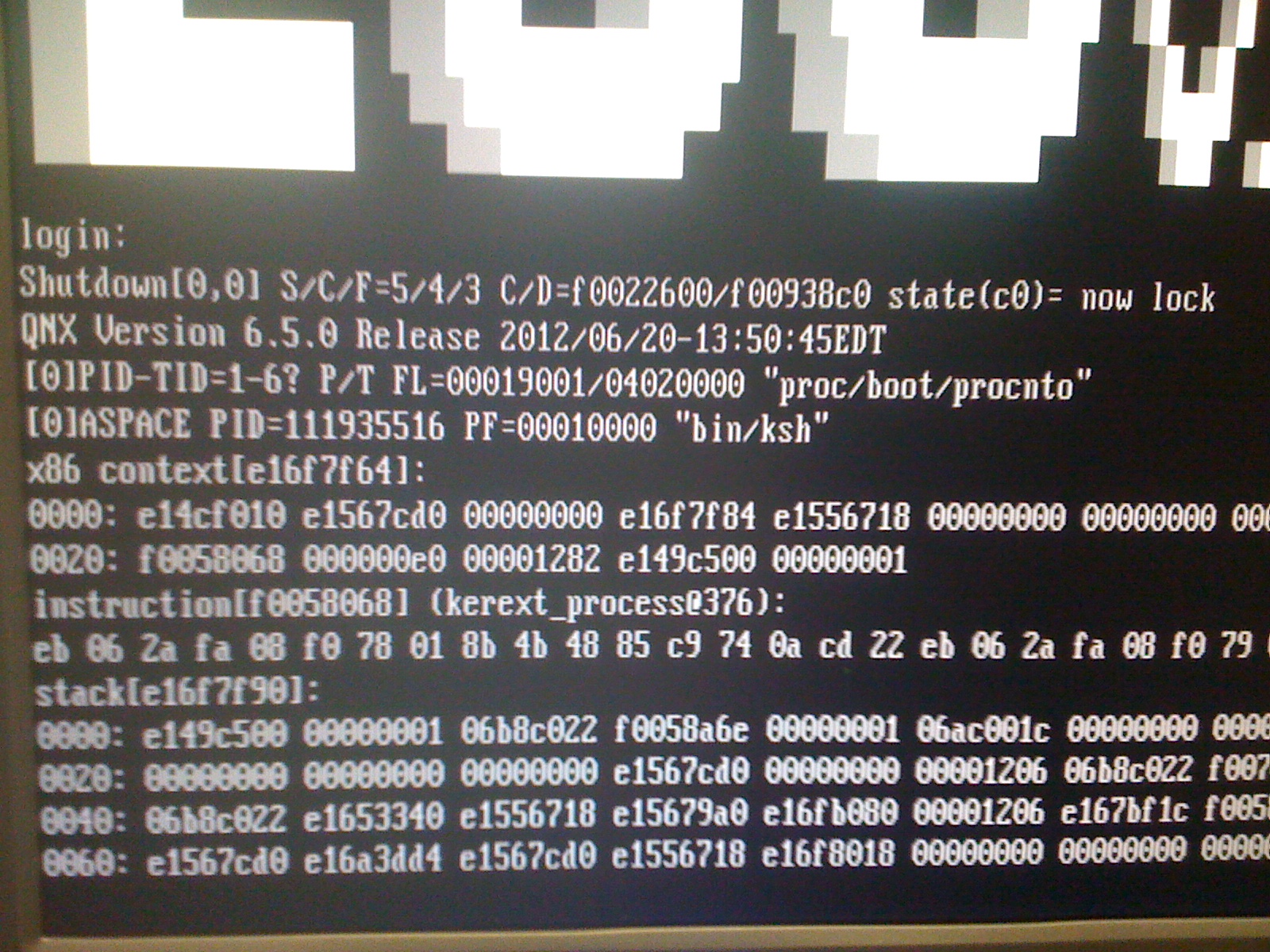

I'm running QNX 6.5.0/x86 and I'm getting often a kernel crash which dump is always similar, with:
- S/C/F=5/4/3
- instruction[f0058068] (kerext_process@376)
Since my only debug device is the screen, I attach here 3 pictures of the kernel dumps.
I just finished looking at the "reading a kernel dump" doc page, so I found out the S/C/F codes meaning is: SIGTRAP +
TRAP_CRASH + FLTBPT

Attachment: Image IMG397.jpg 387.99 KB Image IMG398.jpg 387.67 KB Image photo_node1_blocked.JPG 817.37 KB
