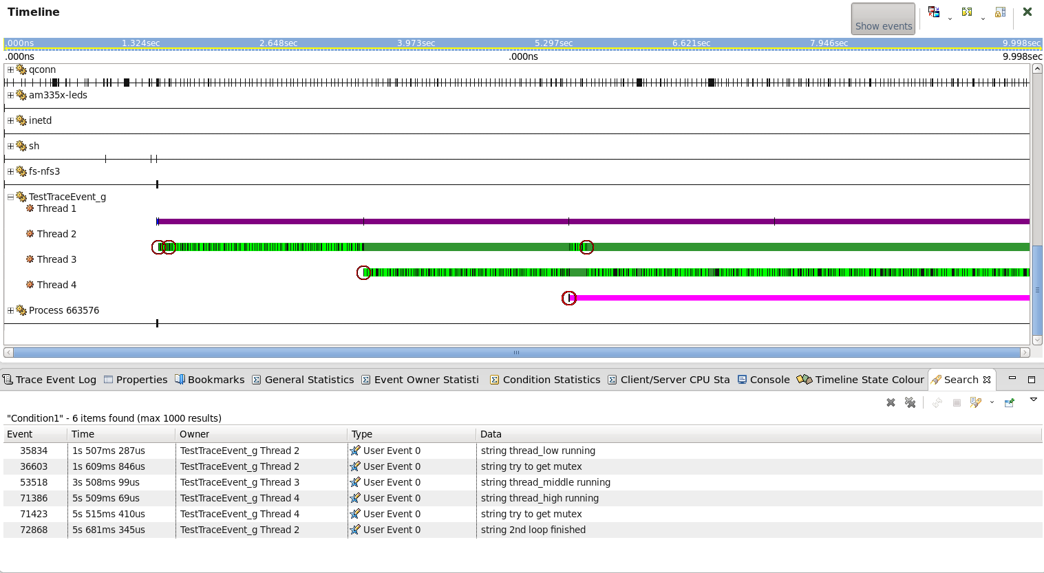

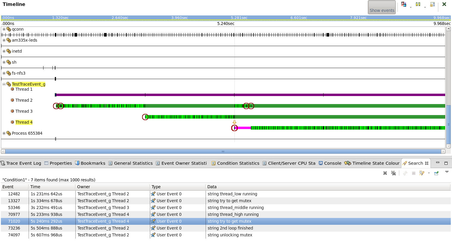

Here is some pseudo-code and screen captures of the thread traces. Note this is on QNX 6.6 on an ARM/TI BSP, in case
there is a BSP or CPU interaction involved:
Initial priority of threads:
T2=4, T3=5, T4=6
T2:
   // delay loop
   pthread_mutex_lock (&mutex);
   // delay loop
   pthread_setschedprio(pthread_self(), 3);
// delay loop
   pthread_mutex_unlock (&mutex);
   // endless  loop
T3:
    // endless loop
T4:
   // delay loop
   // delay loop
   // endless loop
Basically the result is the following:.
1. if we don't change the priority in T2, the priority inheritance works properly. (Mutex_No_SetPrio_154837.png)
2. if we call pthread_setschedprio(3) in T2, then T2 gets blocked and T3 runs forever. (Mutex_SetPrio_155214.png)
Have tried several things such as FIFO, pthread_mutexattr_setprotocol(), etc. None of them can solve the problem.
From the diagrams, looks like the pthread_setschedprio() is setting the effective priority, not the base priority and
doing a max(base, effective).
Attachment: Image Mutex_No_SetPrio_154837.png 94.67 KB
Re: Question about pthread_setschedprio() implementation in the presence of priority inheritance primitives
image with setprio
Attachment: Image Mutex_SetPrio_155214.png 87.25 KB
