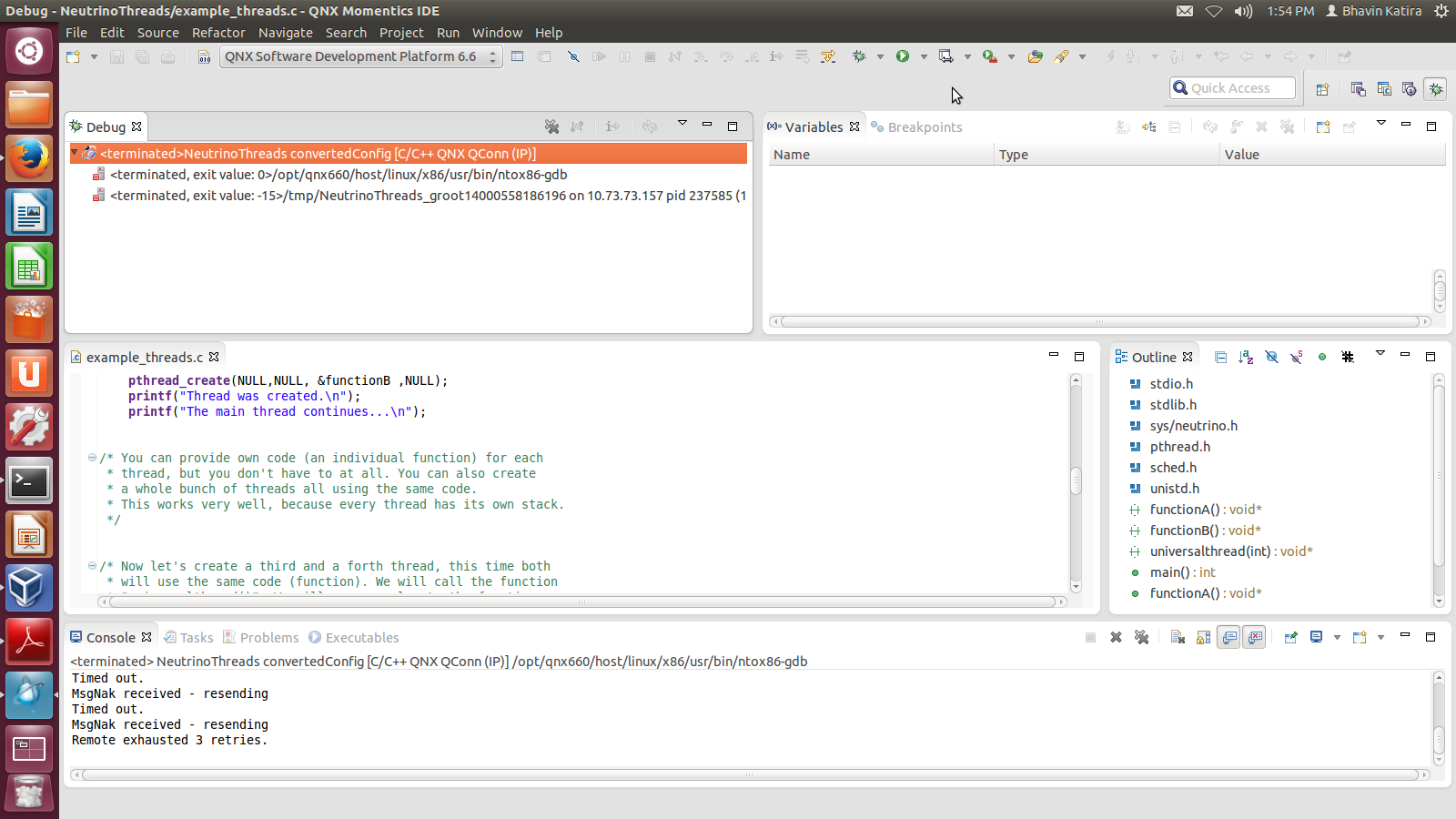

trying to debug:
IDE opens debug prospective .
It try's to run following gdb utility :
/opt/qnx660/host/linux/x86/usr/bin/ntox86-gdb
here is output on console :
MsgNak received - resending
Timed out.
Timed out.
Couldn't establish connection to remote target
Remote exhausted 3 retries.
Connection failed: 5.
Timed out.
Timed out.
Timed out.

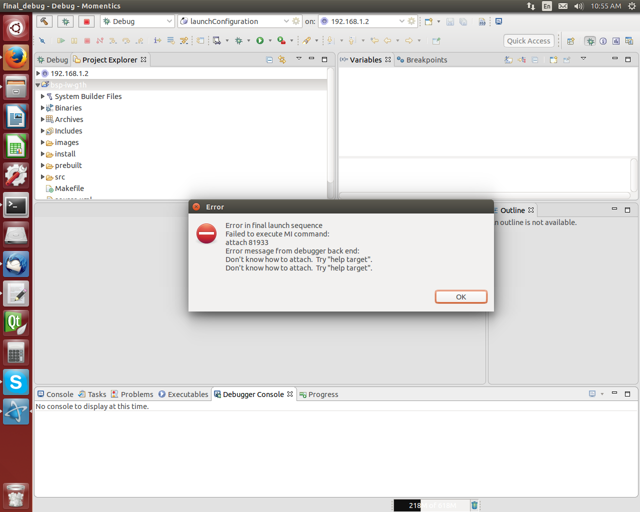

also i get popup error message :
Error in final launch sequence
Failed to execute MI command:
attach 139282
Error message from debugger back end:
Don't know how to attach. Try "help target".
