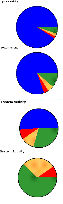

Re: Interrupt Latency
cpu usage at 10khz, 20khz, 40khz and 80khz interrupts
Attachment: Image 10_20_40_80khz.GIF 7.96 KB
Could you post a pic of the timeline view showing the interrupt triggering and your handling running?
The 10khz view should be fine.
Colin
