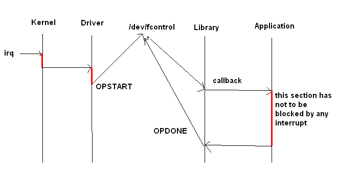

We've an application and a driver. The driver is responsible for real-time communication with a field device. The
communication is done in cycles, 1 ms being the duration of one. During the cycle, there is one smaller period,
announced be the driver by writing STARTOP to a /dev/fcontrol device. We also have a library, that provides an API and
basic functionality needed for communication with the driver. Now, an application registers a callback in this library,
which is called every time the STARTOP is read from the device file by the library. When the application callback
finishes, the library writes OPDONE to the same device. The OPDONE has to be written in 250 us or less. If not, OPFAIL
is generated and the cycle time was wasted for nothing. Now the problem is, that if interrupt comes during the 250 us
period, the application thread does not make the OPDONE write in time. We have tried to encapsulate the application
callback call with DisableInterrupts() and EnableInterrupts(), but the problem prevailed. We have read, that any kernel
call re-enables the interrupts. As we don't have a control of what the application might do when it receives STARTOP, it
 is very probable that a kernel call will occur. How can we make sure, that the the application callback will not be
blocked by any interrupt?
Thank you very much
Dalibor
PS: I've attached an architecture diagram
Attachment: Image qnx_driver_lib.PNG 12.82 KB

Re: disabling interrupts
mouse is not the only device that causes it, it's just the example of one.
We were thinking about it a bit and came to a conclusion, that the problem, as you pointed out, might not be the
interrupts, but their associated driver threads. To make it clear, the 250 us period is counted since our driver thread
writes STARTOP into the device file and then blocks reading the same dev file. The lib/app thread is now unblocked since
 there are data to be read from the device. It does what it has to, writes OPDONE to the dev, then blocks while waiting
for another STARTOP. The driver thread now has data to be read from the dev file, so unblocks, reads OPDONE and the
whole cycle goes on. This is has to be done within the 250 us threshold.
Now, we think the problem might be between the reads and writes, since e.g. mouse driver thread might be scheduled,
putting itself between the execution of our driver thread and the lib thread, slowing the whole process down. Our driver
 is a port from a linux rt driver, that's why it uses device file for communication. Is it possible that the problem
could be solved using native QNX IPC instead of the dev file?
Dalibor
