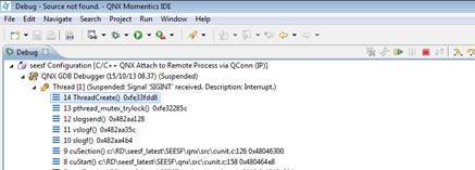

I am currently seing a problem with slogf that I guess could be due to bug mentioned in this thread.
My problem is that the slogf function sometimes blocks forever. If I stop the application in the debugger, I can see
that the thread is stuck inside slogf. (see attached callstack)
If the bug has not been fixed, does anyone have a good work around? (Besides not canceling threads at all)
I was thinking about always disabling thread cancellation when slogf is called, like:
pthread_setcancelstate(PTHREAD_CANCEL_DISABLE, &old);
vslogf("some text");
pthread_setcancelstate(PTHREAD_CANCEL_ENABLE, &old);
Would this solve the problem?

That is what we ended up doing, although, generically, it's better to restore the cancellation state to its previous
value. This can be done with a macro or inline function e.g.:
#define slogtSafe(s, fmt, args...)\
do {\
int oldState;\
pthread_setcancelstate(PTHREAD_CANCEL_DISABLE, &oldState);\
slogt(s, fmt , ## args);\
pthread_setcancelstate(oldState, &oldState);\
} while(0)
